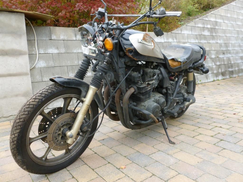

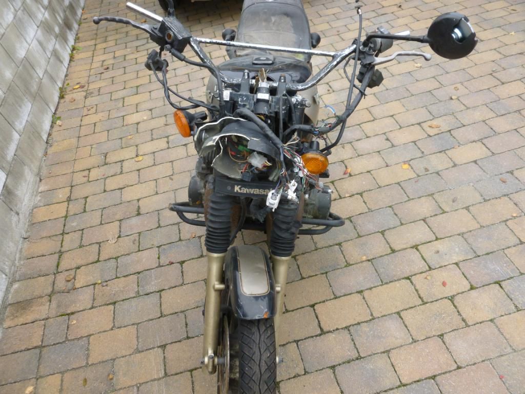

Just been and collected a Crashed 1100 spectre this afternoon :oops: It was Cheap but then it is a Spectre
The Bike had been crashed and then parked up, about 5 years ago. Most of the impact appears to have been taken by the bars instruments headlight area. Looking at it i think i can see a bike in it ........ Somewhere !!
Image :!:
Its dirty and horrible so a good power wash is required :P

I gave it a power wash which has helped :roll:
Then this evening used around 40 minutes Repaired some Wires, fuel, plugs and caps and it runs :wink: So very happy for NKR2000 or just less than £200 :)

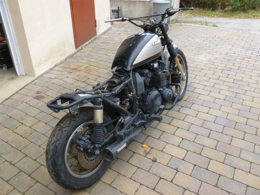

It cleaned up fairly well :roll: and with the removal of some of the damage looks alot better....... l

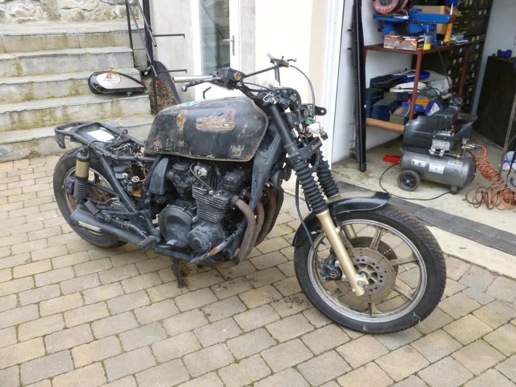

nanno wrote:I have a brand new Z1000P tank kicking about in my shed, doing nothing... and judging by that rear tank mount of yours, it should be a straight fit.
(Which it isn't on a Z1000J and that's why it is still sitting on the shelf)
I may have to add, it was painted flat black with a rattle can to prevent corrosion on the outside, but if memory serves me right, it had a small ding somewhere.
PM me, if you're interested.
Cheers,
Greg (located in Austria, Central Europe)
Thanks for the offer Greg but at the moment im still on the fence reguarding the build direction, i really dont like the Spectre/LTD look :| Which is why i was trying the J tank. I could just paint the whole thing mat black + T Bars and run it"allmost" as is :oops: or i have a set of leading link forks for a Z1100 and a Ural sidecar :idea: but the swingarm pivot width seems to be around the 285mm mark so if i can convert to chain i have a Ducati 916 arm on the shelf......So im spoilt for choice :??

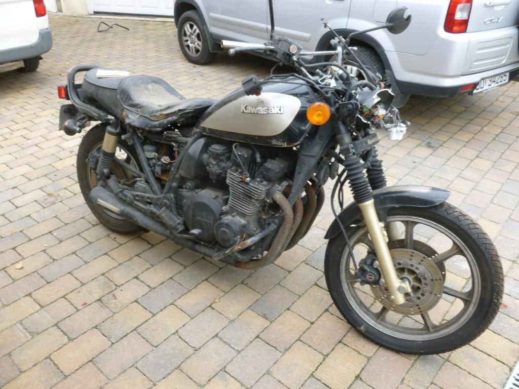

:oops: Sorry for the misinformation in daylight the J/GPZ tank will fit. The spectre`s 2 front Tank locating mounts stick much further out than the J so need trimming back slightly. This allows the tank to sit forward correctly

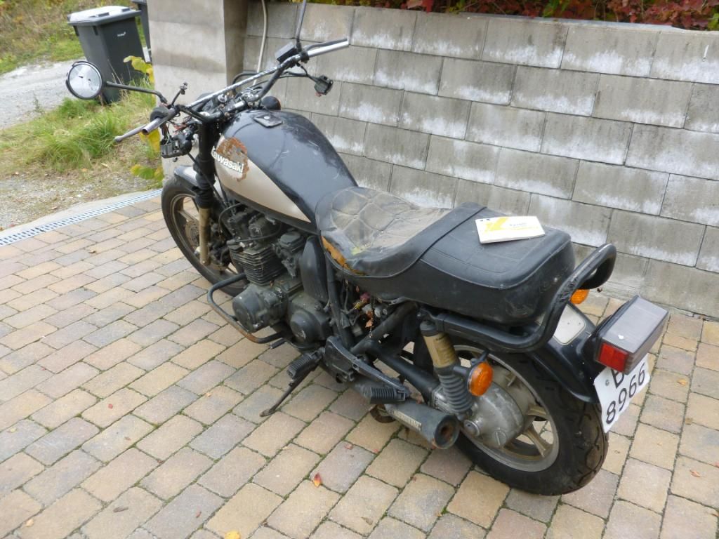

The seat was in a real bad way and not just from the crash damage.
Then i tried on the Zed style seat unit, but i cant really say it looks good :|
I think it just looks too wide, i suppose it being white does not help out either......

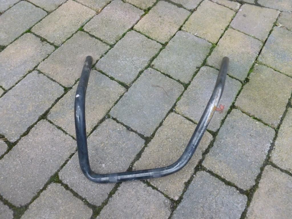

I then offered up an old chopped around Z9 tail, i think this may work ok with a homemade 3/4 lenght seat. Giving the bike a more compact look. A sort of Wrench monkey type of build. I have some Superbike bars on order which should give the look im after.
