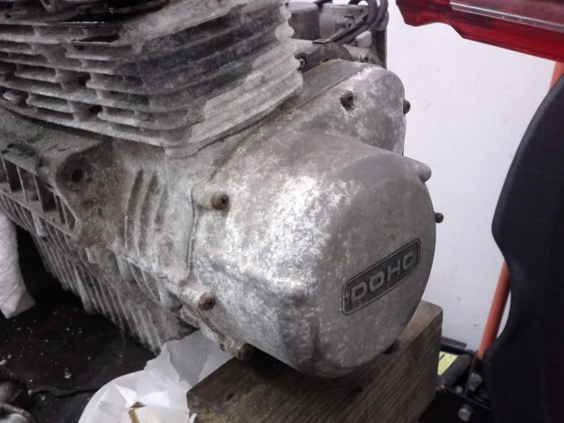

This may take a while :lol: This is the engine from a '74 Z1A that was a barn find and has sat for 15yrs. Its only done 7000 miles and is documented :shock:

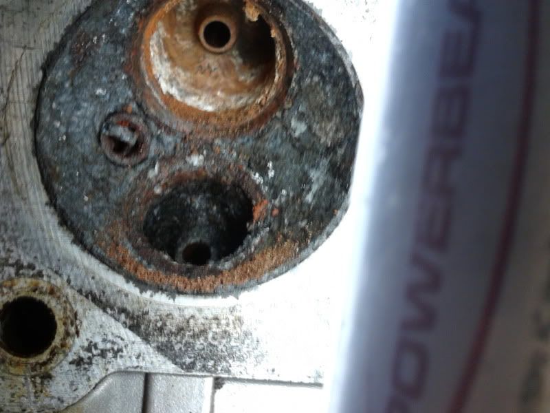

As you can see from the images water has got into one of the bores and the others aren't fantastic. Yep the engine is seized too.
The head needs new guides and probably 4 seats. I'll get this sucker apart next weekend share a few more images and then its off for vapour clean.
I hate dirty engines :evil: Ohh and a plug has sheared-off too. :evil: :evil:
