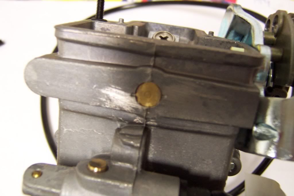

This is a bit of a long story and some of you may already know this but I thought you might like to know….
I’ve been looking on E-bay for a set of Mikuni RS34 or RS36 carbs for a couple of months for Z1000-J1, even bid on a couple auctions only to be pipped at the post.
Anyway September I finally won a set of RS36’s on E-bay I was chuffed to bits, now this might sound stupid but the reason I wanted them wasn’t for the extra performance they provide but I like the look of them – sad I know.
Finally they arrived and I checked them over and they looked fine and seem to work ok to me, dirty and minus the odd screw but nothing that couldn’t be sorted out and I planned to get Mike (dogsbolloxofZ1B) to cast his magic over them and make them look like new.
Mike came over and I proudly showed my acquisition, Mike then cast his professional eye over them and noticed one of the throttle valves was cracked.
I Contacted the seller and the answer was – ‘they must have been damaged in the post and as you left me positive feedback I threw the post certificate away’ sorry “mateâ€￾ I can’t help you’. To make things worse I had left it over E-bay’s claim period.
I’m normally quite a trusting person but for this damage to happen in the post I would expect to see damage to the carb bodies and the packaging and there was none. In my opinion he new they were broken before they were auctioned.
So, I am now the proud owner of a set of broken RS36 Carbs…
I’m now looking to get them repaired, done a search on the internet and the first site I came upon was in Australia, in the emails to and fro I find out the following:
The carbs are old and the throttle valves are made of Bakelite and they do crack, Mikuni won’t sell Bakelite version to replace them and the only way to get them fixed is to send the carbs to a Mikuni Distributor and they will fit 4 x aluminium throttle valves along with a brass button to each of the bodies so that the throttle valves don’t stick.
The reason for this is that Mikuni in the USA was being sued for throttle valves jamming open and they were no longer selling replacement Bakelite versions. If you look at any parts catalogue you’ll see that you have to call a distributor to find out about the modification
Cost from Australia for the parts $8 each button and $120+ each slide, not including taxes or postage – all four have to be replaced.
I then contacted Allens Performance in Nottingham and got the same story total cost £220 excl P&P
So the moral of the story is (for me any way) in future thoroughly check what ever you buy, a lesson learnt the hard way.
I planned to get them fixed and looking nice and clean – it just may take a little while though and there are other things to get on with….
If any one is selling four Bakelite throttle valves for RS36’s please let me know or offer any advice

#15 PostAuthor: Al » Sat Nov 26, 2011 10:37 pm
The early versions have a reputation for slides cracking but i thought they were ceramic not bakelite.
On the plus side; get them repaired with new slides and put the old slides on e-bay. You will make three people very happy at £100 a pop! :D
The side stand bracket does look wonky. It seems to be a common failing. The stand itself looks to be the right one though.
