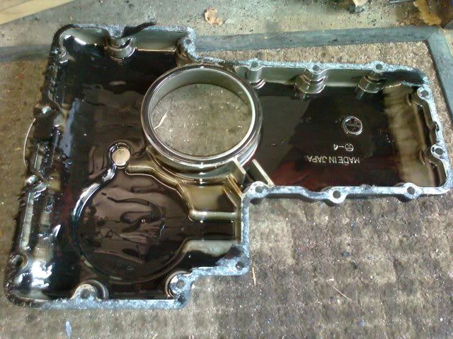

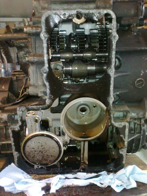

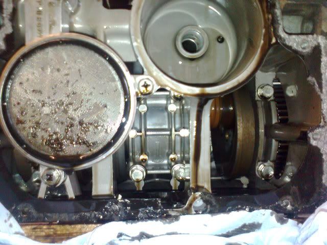

I've also been a busy boy this morning (skipped church :oops: ) and got the engine onto me workbench (OK - so its an old kitchen unit) and took the sump off for a quick looky-see......
So far, so good - all looks OK inside, gears look nice & clean and no visual signs of wear, even on the gear selector forks :twisted:

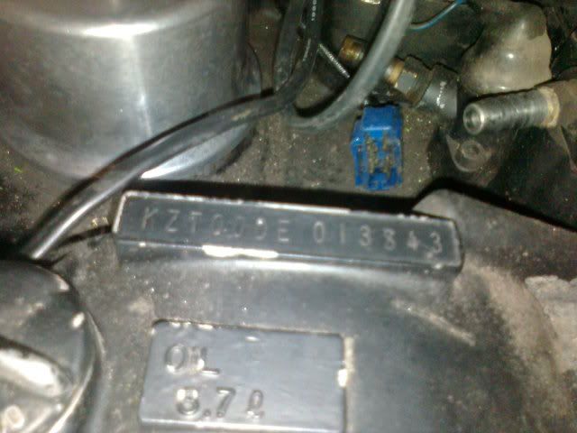

So, is the engine a Z1000A1 :?:

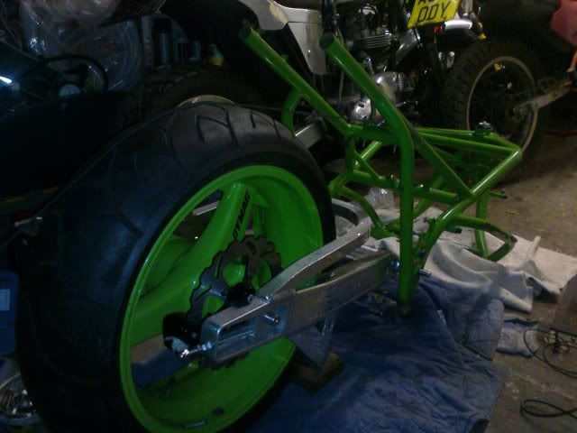

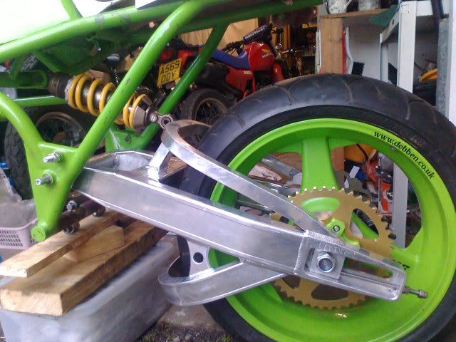

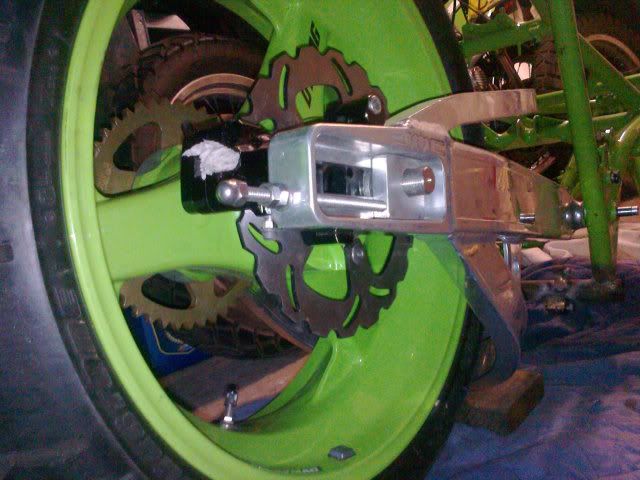

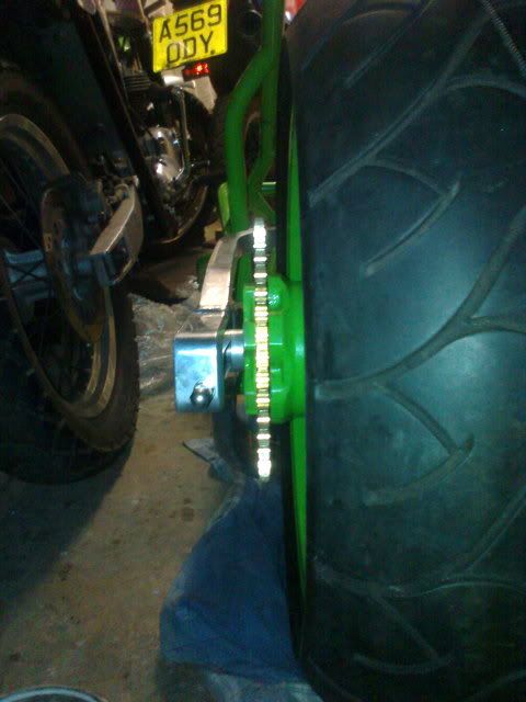

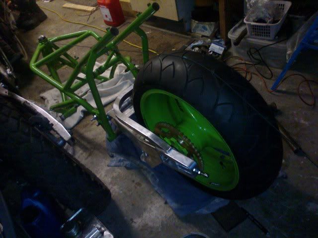

Got all me REAR END stuff back from TALON - I had a s/arm pivot sleeve made, a wheel spindle & sleeve and the JMC trimmed down to fit snuggly in the frame :!:
I spent this afternoon getting the wheel lined up spaced centrally.
I had to make some bits myself - the wheel adjusters that fit in the s/arm recess & has the chain tensioner - I used s/s 8mm threaded rod for that.
The Harrison rear brake has a lug that fits under the s/arm and an adjustable cam on top to hold it secure. :twisted:
The chain run will clear the frame by about 5mm :shock: but I haven't checked it in relation to the drive sprox yet :??
Just awaiting the new stem so I can fit the front end and align the calipers on the forks. I'll need to get an extra lug on each leg to hold the Harrison Billet-6's - this may be a problem as the fork leg alloy can shrink after welding - but my chap will take a look when its time :!: If this is going to be a no-no, I'll make a couple of adaptor plates from 10mm alloy plate.

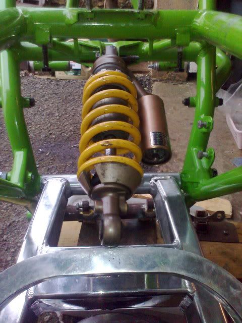

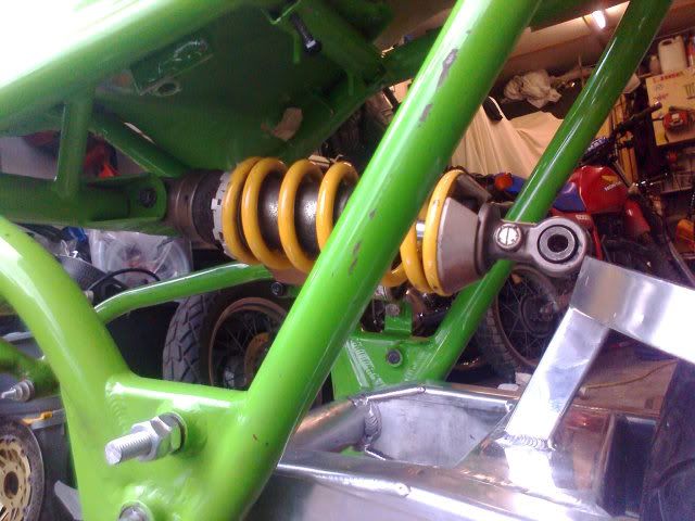

Bit more fiddling in the garage ....... Trying to get a rough idea of the set-up with the rear shox :??
Its a Showa off a Ducati 916...

I took the clutch cover off to free the plates :| ......as it's been off the road a few years, they needed a bit of gentle prying :!: I also took the opportunity to fit a "Needle Roller Push Mushroom" as well :wink:
Now checked all the valve clearances - closest was a tight 0.05 EX - and one inlet at 0.20mm :roll:
