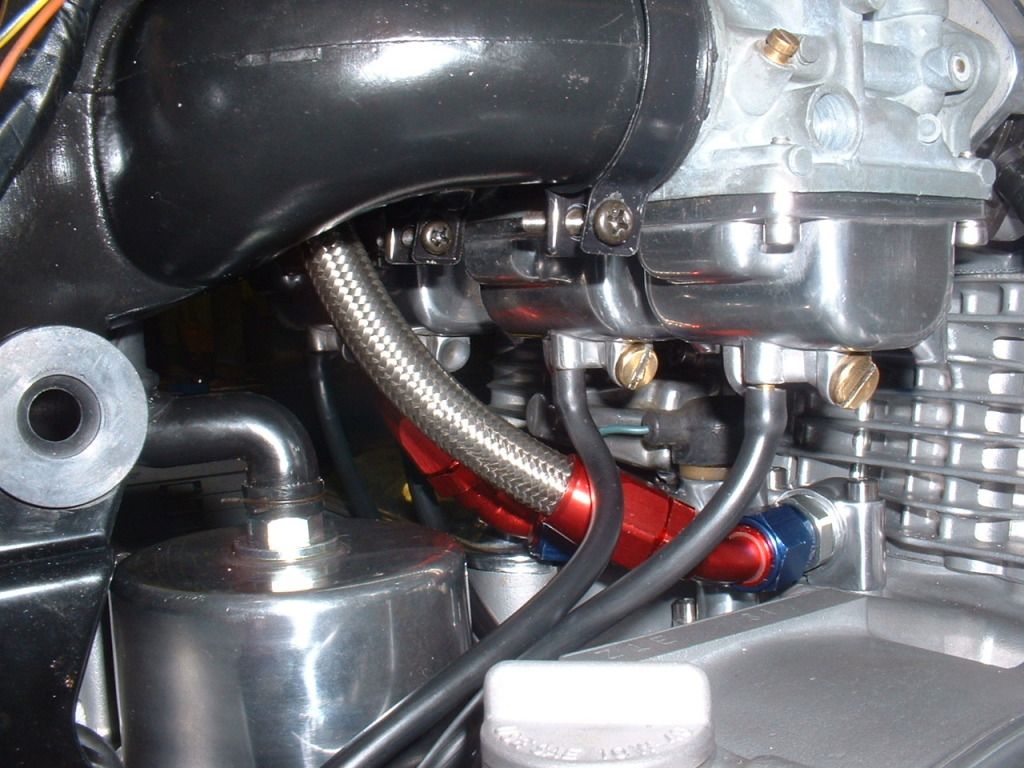

And again from the front, next job to make the lines off to make them go between the carbs and air box, over the top of the engine and to the cooler, its going to be tight but will look a lot better then going round the side of the engine.

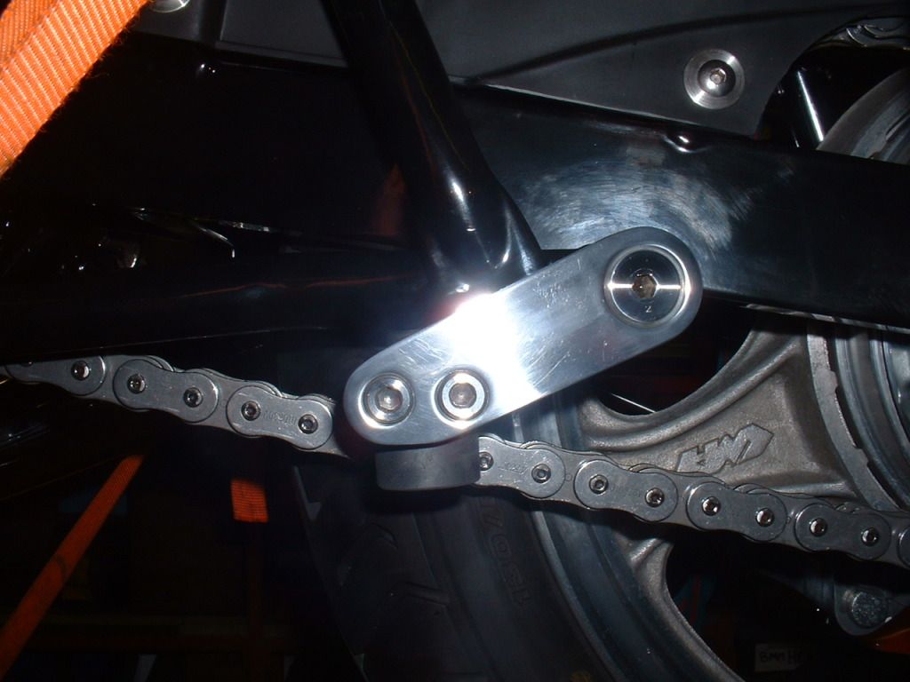

#52 PostAuthor: andy c » Mon Nov 12, 2012 1:37 pm
Centre stand stop finished, needed to get this done ,bike now in final stage of being finished and need to get my bandit 1200 on it for a service and bloody good clean.

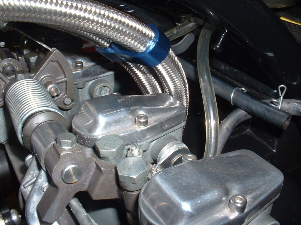

Lines in, what a fight a length of -8 hose can put up

#56 PostAuthor: andy c » Mon Nov 12, 2012 6:59 pm
then between carbs and airbox.

#57 PostAuthor: andy c » Mon Nov 12, 2012 7:03 pm
Over the engine, under frame to the cooler . Job done.

#58 PostAuthor: Pigford » Mon Nov 12, 2012 7:25 pm
Looks damned smart :!:

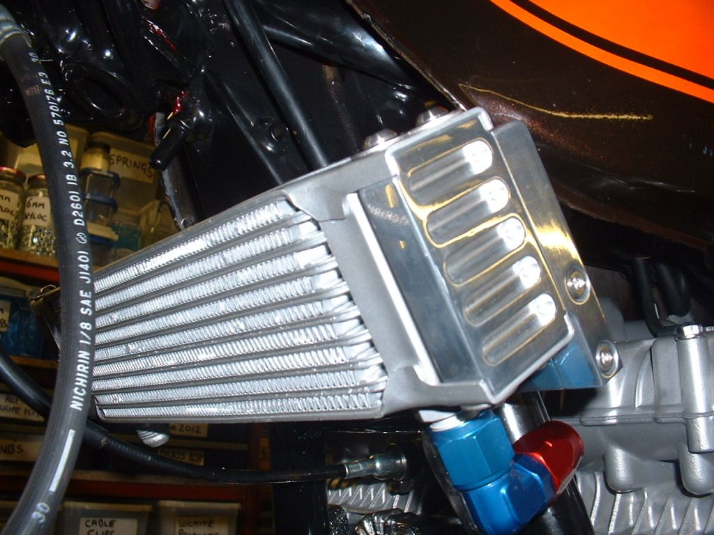

My Z1000 has the same arrangement - but cooler connections are on top - gave better clearance and also helps make most of extra oil capacity.....

#59 PostAuthor: andy c » Mon Nov 12, 2012 7:59 pm
Piggy I tried it your way round for the same reasons as you but in that position on mine I had issues with full lock on steering hitting it. Last time I fitted a oil cooler I had electronic tacho and old cable drive blanked off, this is the way to go on trick bikes, you loose the cable and it gives you a bloody huge space to play with.
