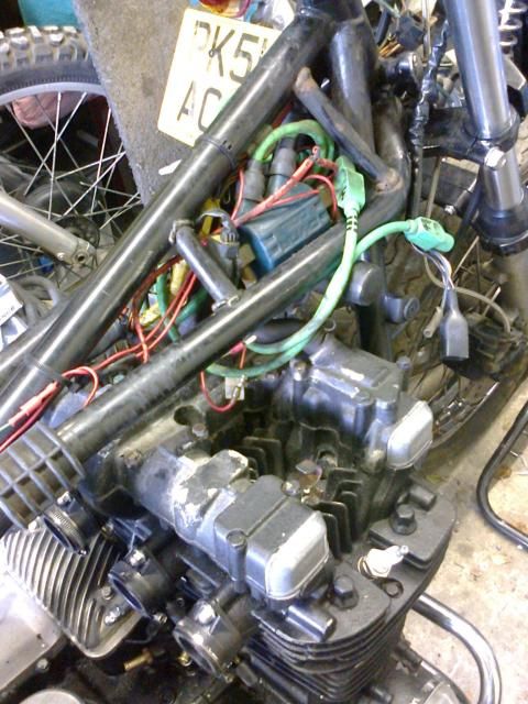

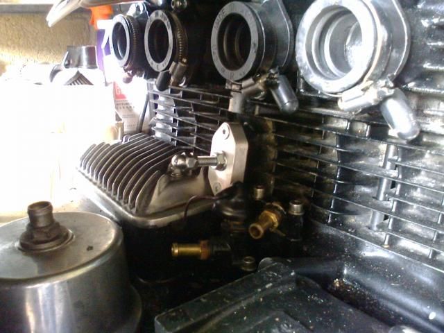

Last night I got the tank off and found a pair of Green Dyna coils already fitted.... then took the carbs off and fitted a manual cam chain adjuster and some oil cooler take-offs.

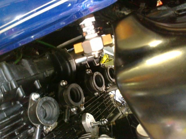

Here's the oil cooler take-off's, cam chain adjuster & new carb rubbers fitted:

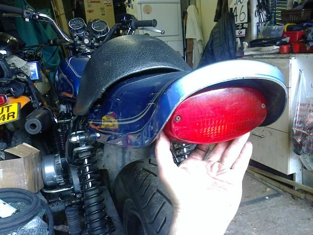

Found the ER6n light I had stashed away for the last couple of years - it'll look smart:

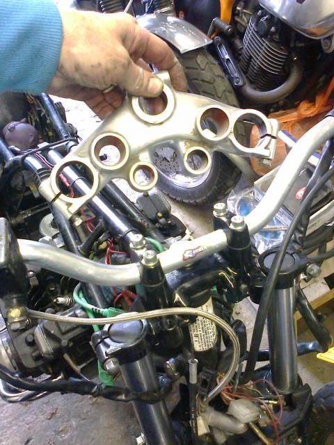

I have fitted the older Z1000 front end c/w Z650 yokes... but this has raised a couple of points which I wasn't aware of
1: The clock mounting arrangement is different.
2: And so is the wiring.
Not insurmountable, but a PITA
I've also changed the R/H switchgear as the LTD has lights ON all the time - so again more wiring changes.
Photo's to follow
Photo's to follow

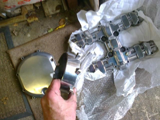

Had a bit of a sort out in the garage - as I couldn't find me round cam cover
But found it at last......
The wiring needs a bit of a sorting

Here's the different top yokes - need to paint the bare metal one now so I can fit the clocks easily

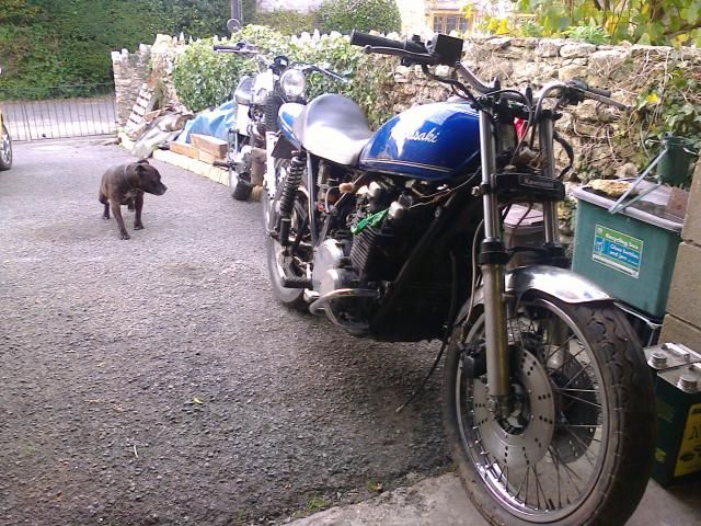

Wheeled the bike out and took a shot of the bike with the new/old front end
Making some slow progress - don't think the cam cover will fit without messing about - not only does it foul the chain idler! but the exhaust valve "air emission" intakes need blocking up

The cam cover difference seems to be extra clearance for the cam sprox on the MKII cover - therefore the Z900 type touches the cam chain on the sprox.

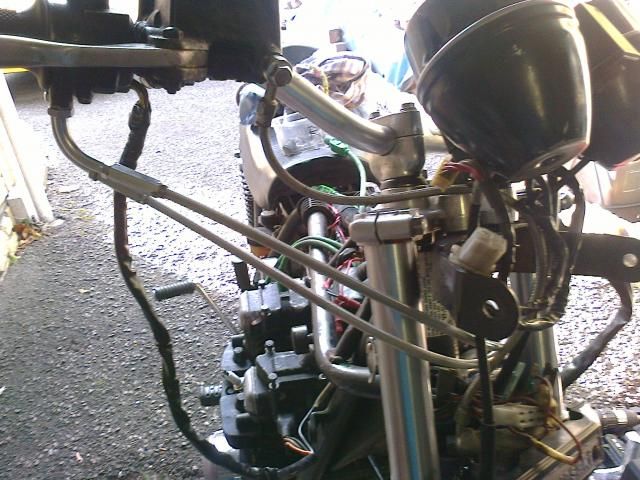

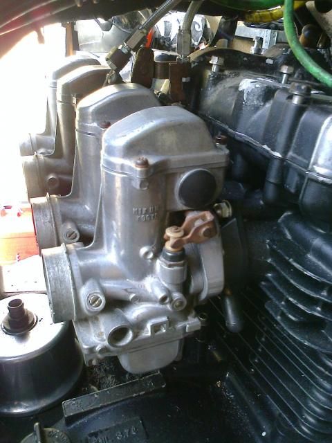

Dug out some bling - my braided throttle cables
....which are now connected to the VM29 smoothbores...
It'll be a case of messing with the wiring next
