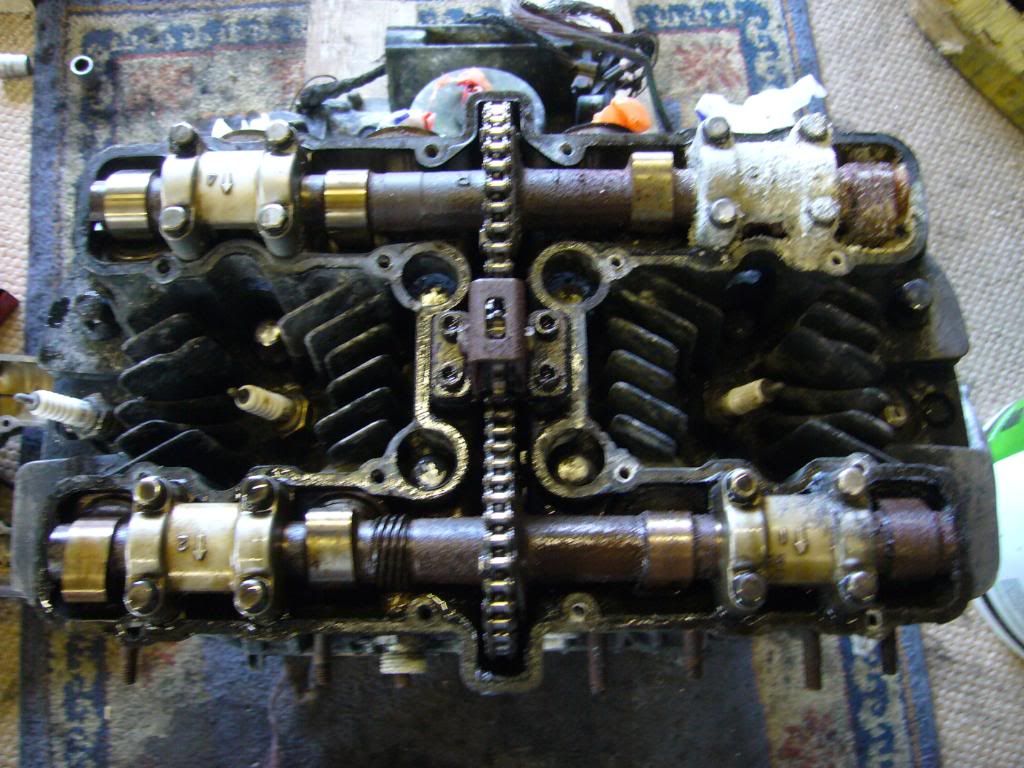

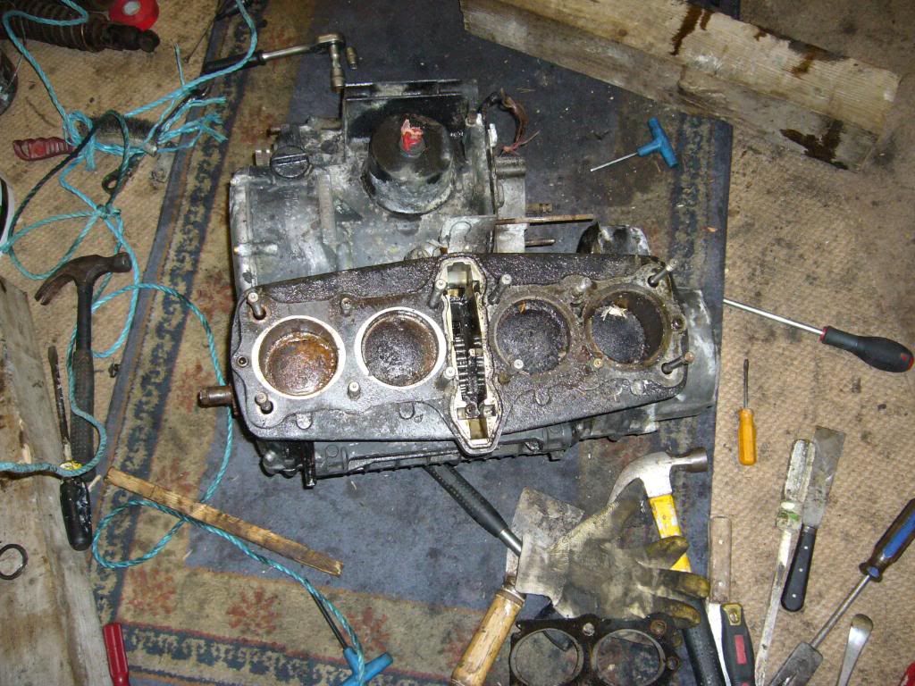

strip of the donor motor begins, god knows how long its been standing Image
the head was reluctant to come off & needed a heavy hand
this looks a little bit rough

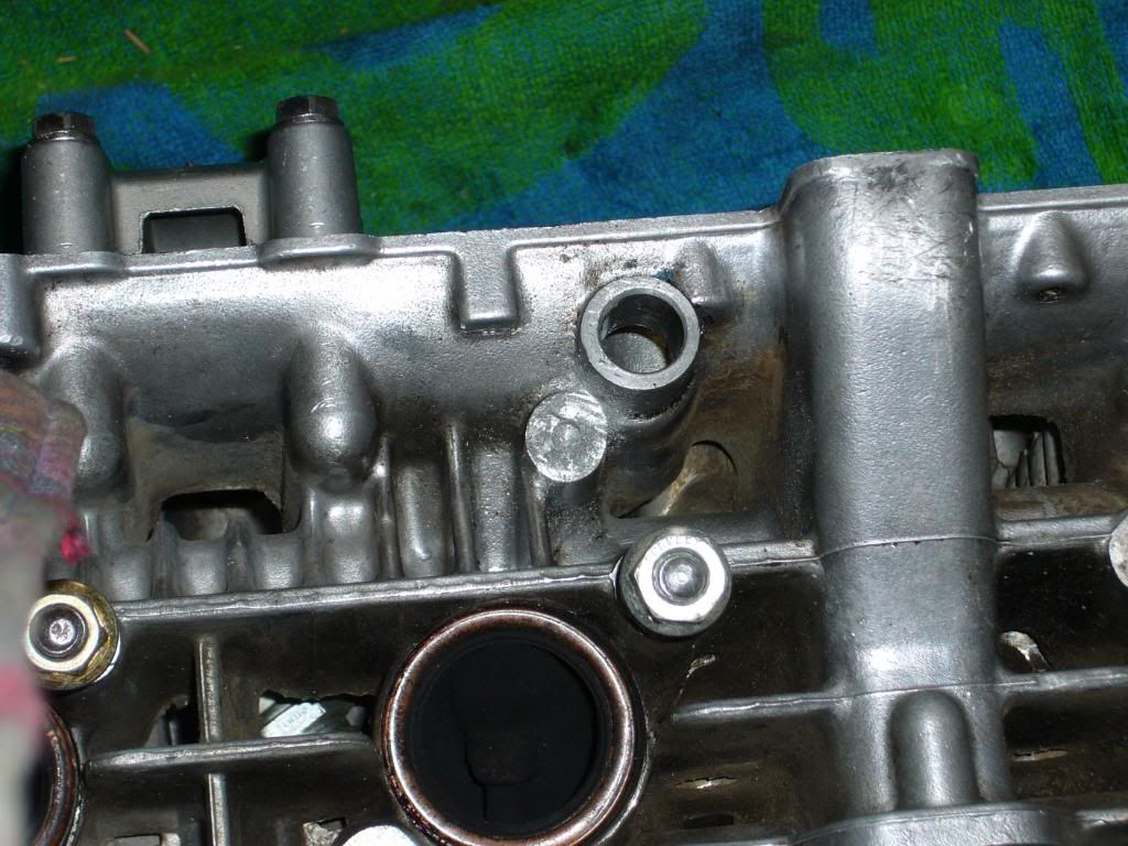

had to drill out the engine mount bolt which sheared off, rusted in place Image
having got this far it was noted that these cases had previously been repaired but still needed further welding works and to be honest were in worse condition than my original cases, so i decided to go with my orginal cases, the crack was grooved out ready for a weld repair
Image Image

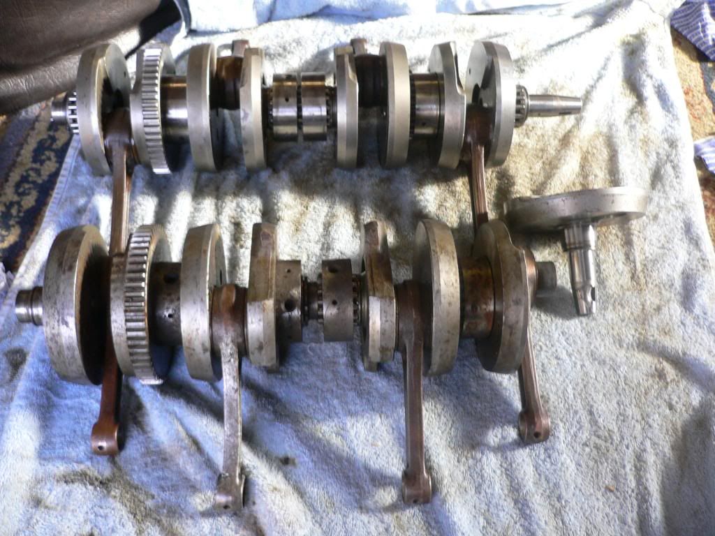

repair works carried out to the crank, i managed to find a knackered crank with a bent conrod, the rotor end was pulled off & pressed & balanced onto my original damaged crank [ps this was sorted before the donor motor turned up]
Image Image
