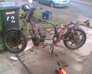

Hi all,

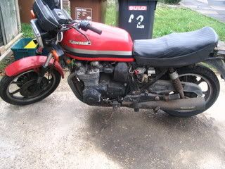

Thought it about time I put something on here about my Gpz1100b1.
I got it about twelve months ago in part payment for a bus I painted and havent had ether the time or mony to do anything about it apart from get afew parts here or there.
Image Image

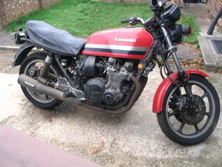

A bit ratty I know but thought i'd have a go at cleaning it up to see whot i could do.
Image Image
got abit carryed away might have to do something about it now?

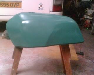

#5 PostAuthor: crazy col » Mon Mar 23, 2009 9:21 am
Thanks for the comments

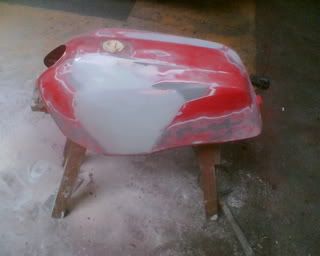

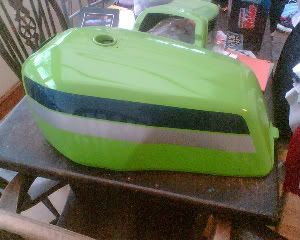

Always thought big zeds should be green (personal tast), so got on with for me the easy job first, repairing and painting the tank ,side panels and tail fairing
Image Image
Afew dents but not bad

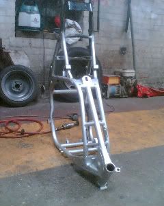

#8 PostAuthor: crazy col » Fri Mar 27, 2009 10:43 pm

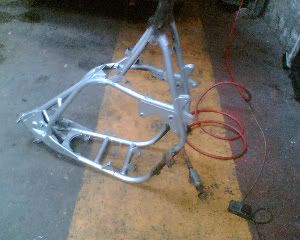

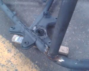

I thought I'd try and strip the frame the cheap way with wire brushes on the good old angle grinder and die grinder.
Image Image
Did'nt come out to bad really, just could'nt get into all the nooks and cranys so bit the bulit and had it media blasted.
(the silver by the way was just a Alu zink based primer just to stop it rusting again).

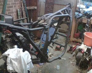

#9 PostAuthor: crazy col » Fri Mar 27, 2009 11:05 pm

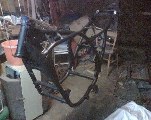

Got the frame back from media blasting and was pleased with how good a job they made for the price I paid.
Two good coats of etch primer and then a coat of black primer later it
it don't look to bad, shame about the stat of the garadge though.
Born again biker and to old to know it!

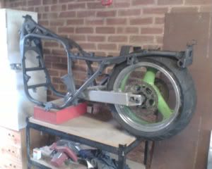

#11 PostAuthor: crazy col » Mon Mar 30, 2009 2:29 pm

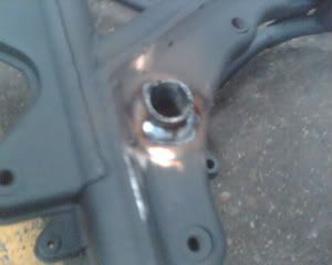

Thought i'd have a play over the last week and got the ZX7R swingarmout that i got off ebay afew months ago out and see if i could get it to fit, i think i proberbly could have given enough time, but see ing that the bearings were buggered it worked out cheaper to get another off a zx6r that was a bit narower .
I know everybody says to have a new spacer made that will take the original spindal but i like to be a bit diferent.

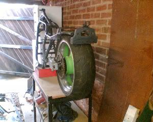

I ground the welds off the bushes that the spindle goes through on the frame each side so you could pull them out then replaced them with ones of the right size for the new swingarm.
Image Image
Fits like a dream
Image Image
Do'nt think it looks to bad either.

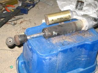

I have got hold of a pair of rear showa shocks off ebay for a reasonable price , which I've cleaned up and had the springs powder coated.
Image [img][img]http://i218.photobucket.com/albums/cc270/convert1966/57.jpg[/img][/img]
A bit gruby but not to bad, I think they came off a H***A CB900F1
same size, just the ticket
[img][img]http://i218.photobucket.com/albums/cc270/convert1966/80.jpg[/img][/img]
Home made spring compreser.
When your on buget as small as mine you have to use wot you have!

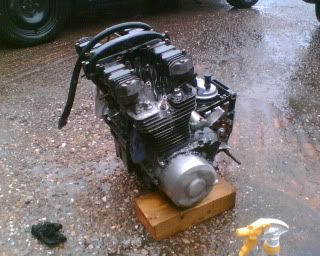

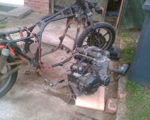

I managed to get the engine cleaned if only with TFR and a jet wash, just to get the crud off so I could get it back in to make sure everything lines up.
Everything looks ok so I can strip it down get some shock mounts welded on to the swing arm and finally do some painting
