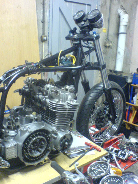

Hi Chris, Ginger Bear suggested I had a look at your
project thread, and wow, that front end really suits your bike,
and I hope you don't mind if I copy it
How do you find the handling / ride comfort etc.?

chrisNI wrote:Handles okay, not sure it's much better than it was to start with, but with most specials that's what your aiming for as some handle worse than a standard bike...Still developing it really.
Comfort is fairly good, Edersee last year was quite a long run and was no problem whatsoever.
Yeah I know what you mean, when I had built my
z900 with a JMC monoshock it was such a much harder ride and a be-atch to tweak the suspension as the shock was just conventional not a gas one, and on first ride out, it was a bit like riding a bucking bronto around corners
That's why basically I just want to budget where I can on the parts that I can avoid wasting thousands on, like the front disks and calipers too, as the standard Kawasaki one's that come with the forks will be better enough than the old Z series calipers etc.

chrisNI wrote:Yokes!
Chris,
did you have these yokes made bespoke for the forks?
~Jay.

Yeah Nigel Kimber NK Racing made them. I needed a bit of extra width to use the Tokicos with the spoked wheels, and a bit more step and offset than Zx9 yokes - which is what the forks came off. With hindsight I should probably have just put the Billets back on it they were better stoppers. They're going to go on the Lawson now.
