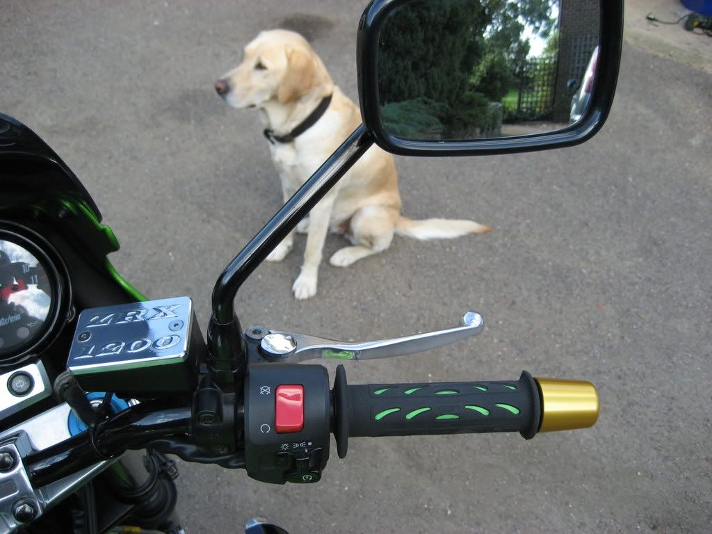

ZRX levers are dog-leg ones and span adjustable (dog included for comparison purposes).

Chrisu, thanks for the pics mate. You've saved me a trip to the breakers.
