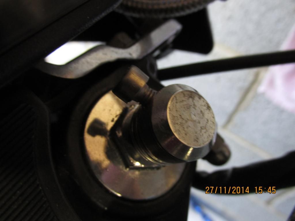

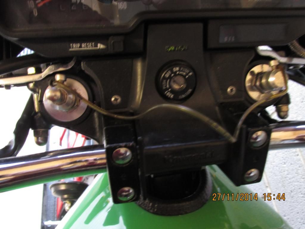

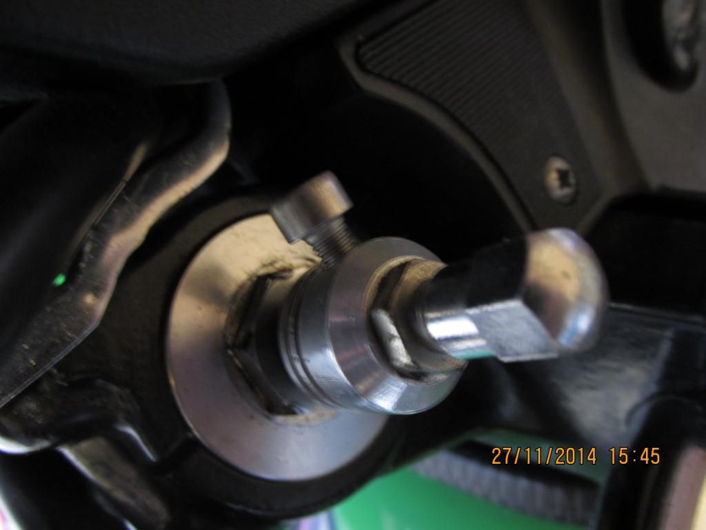

The front forks on my 1984 Elr R2 started leaking last year and I had the seals changed. I then still noticed a small amount of oil and saw that the thin tube had a hole in it.

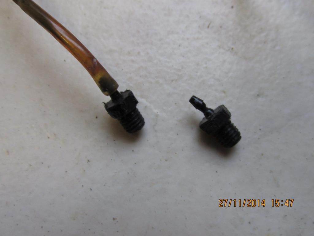

Ignore the M4 socket bolts as they are there to block the hole where the little black nipples were.
I have since found out that the caps and tube are not from an Elr.
I hope that someone on here might recognise what bike they are from.
Stu

they are the original tops but someone has made a pigs ear job of modifying them to balance the air pressure. the original tops have individual air valves to pressurise the forks & are not linked together

So each side should have a valve, with no threaded hole ?
That makes sense as it is indeed an interesting engineering job.
It looks as though I will have to try to source two of the complete unaltered valves.
Stu

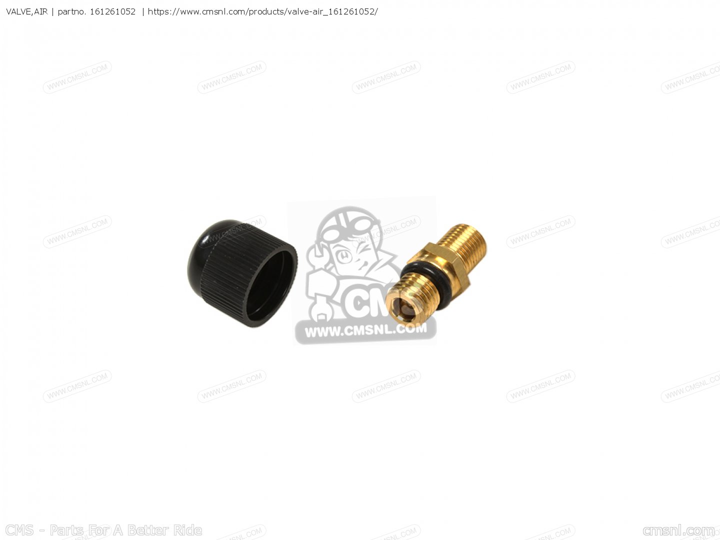

this is the air valve that fits into both fork tops

The balancing mechanism on some forks is because it is logical to think that the pressure in each fork needs to be identical or the forks will twist, in fact the spindle clamped into the legs, the two wheel bearings fit in the spindle and the mudguard stay mean that the fork legs act as one and the differences will simply average out.
Don't believe me, look up the H**** Pan European ST1100, that has compression damping in one leg and rebound damping in the other.
Stugill it looks like you could unscrew the aluminium adaptors that someone has fitted to your standard fork tops and fit the standard air valves. If the thread has been changed to suit those adaptors you could just blank them off with a bolt of the correct thread, the forks will work perfectly.
