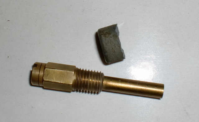

At the tail end of last year my '72 suddenly started running horribly and I found that the 'boss' in the carb bowl that the emulsion tube screws into had broken and fallen off on No1 pot (someone in the last 42 years had obviously screwed it in too tight at some time and cracked it; not me I hasten to add! :)).
I've tried getting another carb body but all the ones I've found are the '73/Z1A type with the larger ribs. I'd really like to repair this carb body so I'm looking for suggestions.
Here's the broken bit:
Ideas I've had so far (comment and suggestions very very welcome):
A) Epoxy (JB Weld) glue it back together (the break is such that the parts locate back together nicely) and reinforce around the outside with more epoxy glue/putty. I've googled and some say JBWeld is fine immersed in petrol and other say it'll dissolve in days.
B) Glue it (superglue or somesuch just to hold it temporarily) and heat shrink on a thin aluminium sleeve to hold and reinforce it.
C) Get it micro/laser welded back on (I've found a chap in the USA who's been repairing H*dna carbs in this way http://forums.sohc4.net/index.php?topic=118804.0 and there are firms advertising laser welding for micro welds a bit closer to home. Anyone got a recommendation?).
D) Errr..... over to you guys. Ideas please.

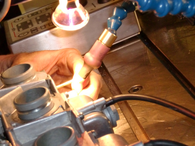

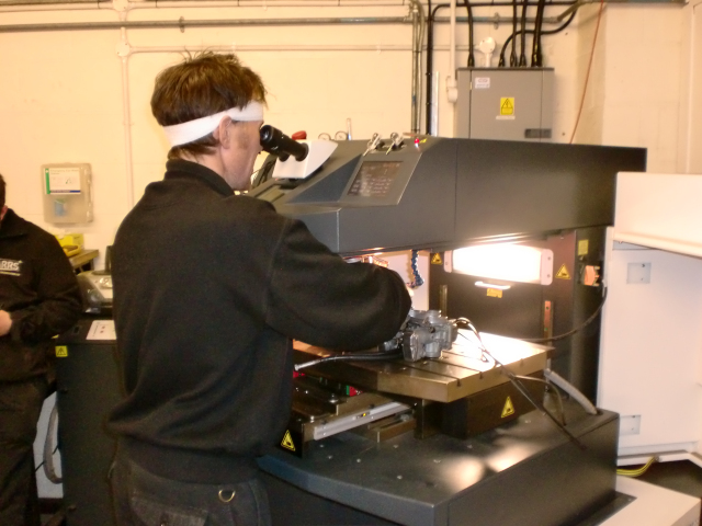

Well I tried the laser/micro welding. Went over to Carrs Welding in Kettering and they were really really helpful. The chap that wielded the welder, Alistair, is a biker so knew the score.

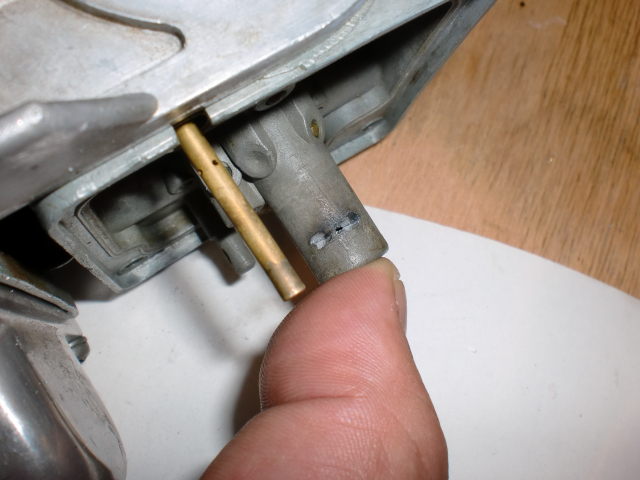

Here's the carbs on the machine with the broken bit being held in place by the welders finger. Apparently you rapidly learn not to put fleshy bits in the path of the laser... and if you do, it cauterises the wound automatically :) The pink thingie is the laser and yes he was using a hair-thin filler rod but moved that out of the way for the picture.
Unfortunately it didn't work. The carb body had too much zinc and just popped, fizzed and fell apart under the laser. Alistair was sensible enough to say it wasn't going to work and stopped before any damage was caused.
Fortunately, the micro welding really is micro and the blowouts havn't destroyed it so I can fall back to plan B and try JB Weld marine epoxy which, according to JB Weld.co.uk, is impervious to fuel once cured.
I think I'll use a teensy amount on the joint and then epoxy an aluminium sleeve around the outside as under the microscope it's obvious that there are other cracks in that bit of the casting.
Just for my amusement, Alistair demonstrated the micro welding on a scrap bit of ally and produced a hair thin weld (I could hardly see it even with the bins on) that under the microscope looked just as good as any welding I've seen... except it was less than a millimeter wide :shock: Impressive even if it doesn't work on 42 year old alloys of unknown composition.

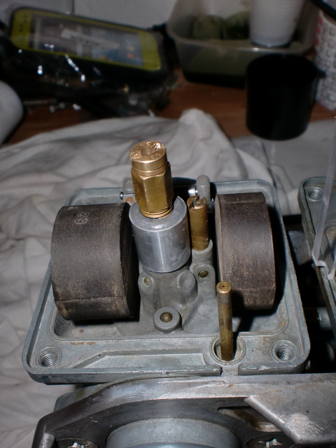

After all the suggestions (and many thanks for the ideas) I went with the epoxy and sleeve method.
I first epoxied (using JB Weld marine epoxy which, according to the man at JB Weld.co.uk is fine with petrol once cured) the broken bit of the casting back on using the teensiest end-of-a-cocktail stick amounts of gloop.
Then I turned up a sleeve with about 0.5mm clearance at the top (bottom as you look at the picture), spread a thin layer of epoxy on the carb and more in the sleeve before pushing it on in the hope that an all-over layer of epoxy would reinforce the other cracks in the casting.
