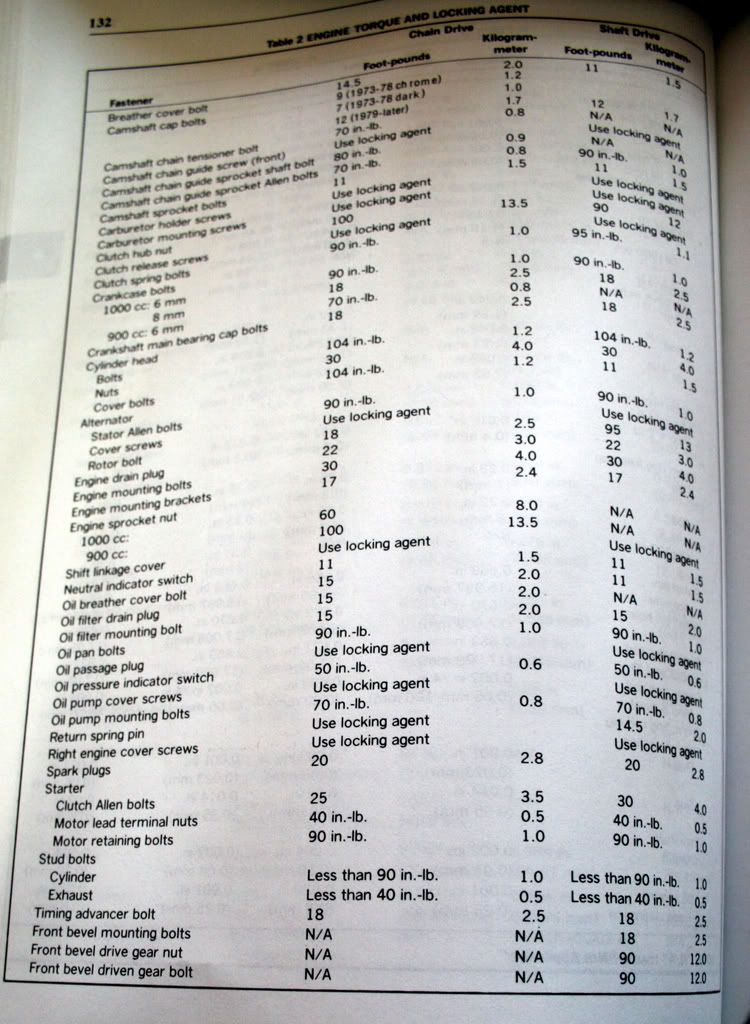

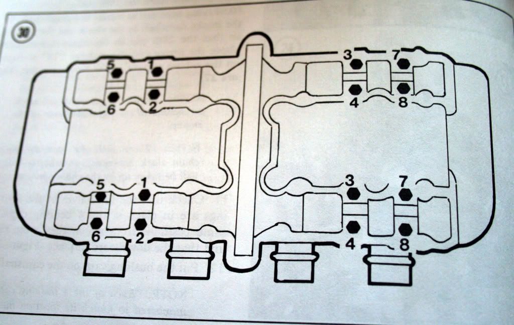

#1 PostAuthor: kenny z9fighter » Mon Sep 24, 2007 7:39 pm
i'm in the process of putting the head back on to my 1075 wiseco z1 after a cylinder head repair,the problem is i cant find my manuel!i'm quite shure i can manage but would like to know if there is any downloadable stuff before i rip the house and garage apart or buy another manuel.cam chain timing,torque settings,etc

#4 PostAuthor: chrisu » Tue Sep 25, 2007 8:54 pm
I'll see if I can scan/post the relevant pages tomorrow.
so you want :
Timing setup
head torque settings
anything else ?

#6 PostAuthor: chrisu » Wed Sep 26, 2007 9:10 am
images from the clymer manual in case the hayes "book of lies" isn't clear.

#9 PostAuthor: chrisu » Mon Oct 01, 2007 5:09 pm
photos above were from the clymer manual.
