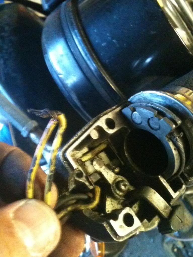

#6 PostAuthor: Vendetta761 » Mon Jul 08, 2013 8:39 pm
mm, stuck a spare plug in each HT lead and cranker her over with the kill switch in all 3 positions and each plug sparked..
don't think thats right so I just took the R/H switch gear apart and :
no connection at all!
except this.
Think i will swap over the switch from Olive and see if anything gets better, I must get something running in this lovely weather!
I suspect however a total rewire coming on....
