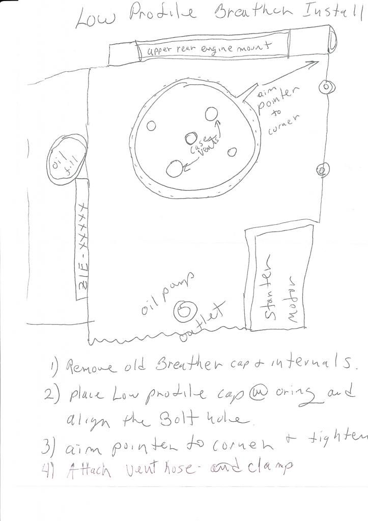

I have two of these and I just noticed something, (both are slightly different) don't know if it makes any odds but perhaps those with the low profile jobbie can tell me what one they have fitted and if they fitted it as per OldKawmans instructions.
http://www.oldkawman.com/z1parts.html
Just wondering if the orientation is important or even key to stopping oil blow? Seems like the pointer (tab) is there for a reason. Looks like the filter (breather) would sit slightly askew to the left following his instructions.
