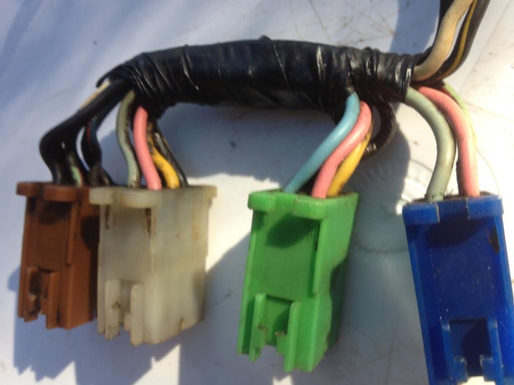

got a combined unit for my a4, 1 black to earth, 1 red to battery and 3 yellow, my question is where are the 3 yellow connected to? is it the green plug? i can see there is a yellow.pink and blue wire, do the 3 yellow connect to these?

The connecting block for the combined rect/reg goes to either the green or the white terminal block, they have identical wiring. These blocks are the usual blocks for the separate regulator and rect, respectively.
The yellow, pink and light blue are connected to the 3 yellow wires in either green or white connector block. The red is connected to the white wire in the same connector.

Wayno, sorry I gave you a bit of mis-information in my last post...
As stated, I always use a Six wire combined reg/rect not the Five wire.
Note that the light blue, pink and yellow wires are common on the white, green and blue terminal plugs, however, the blue plug contain these wires coming directly from the alternator, whereas all three of these wires feed the green and white plugs.
My mistake to you, is to say that the white wire is connected at one of the above plugs, however, I notice that the above three mentioned blocks, do not contain a white wire. The white wire is in the brown plug, which gets its power from the white wire from the +pos of the starter terminal/+ve terminal.

To satisfy Wayno and myself...
setting up the Five wire combo rect/reg unit.
The 3 wires all yellow (or light-blue, pink and yellow) connect to the green or white plug.
The black wire goes to earth.
The red wire connects to positive from main positive lead which goes via a fuse and starter solenoid terminal.
Will that work? or should the red wire connect to a brown (switch) wire
In which case, what is the advantage of a six wire over a five wire? or vice versa~
