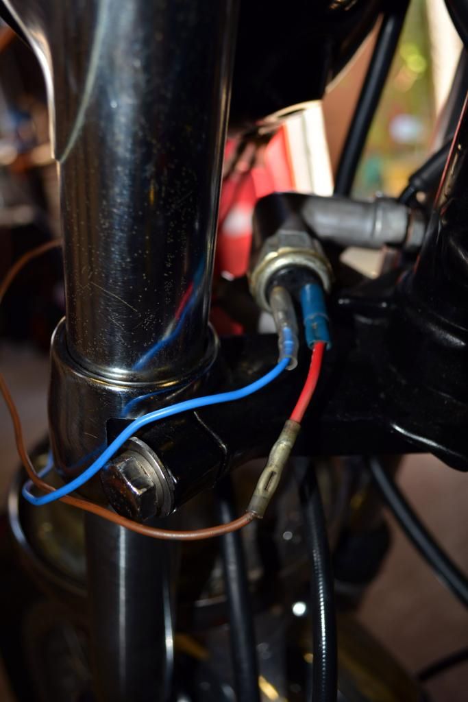

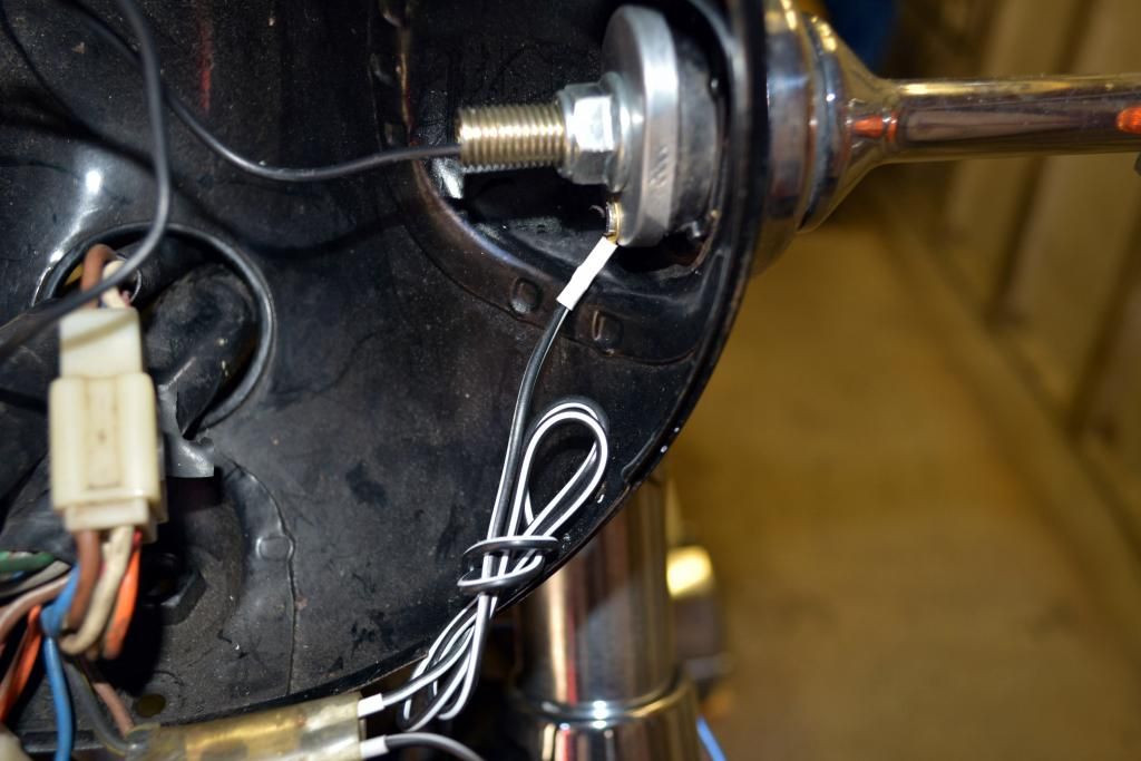

OK, so I decided to get the brake light working off the front brake lever as I'm now using a new (old) splitter I bought off Ebay. The splitter is like new, a right good find, so no reason to suspect anything amiss here. Previously the bike had no splitter and just ran single brake lines direct to the calipers.

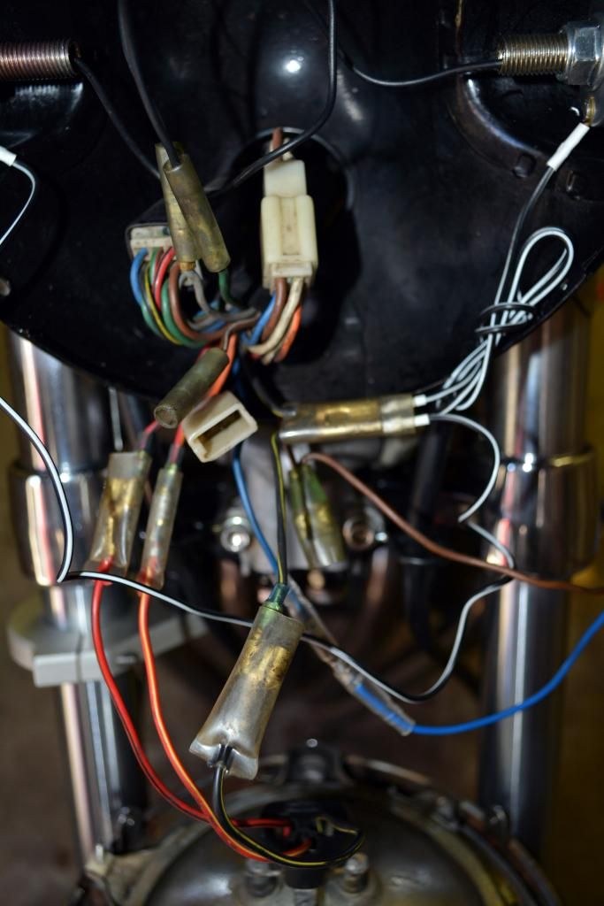

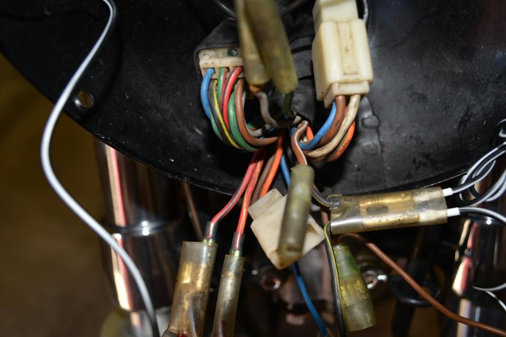

I'd asked on the forum previously and was told that the blue and brown wires in the headlight go to the splitter. (see photos). BTW the wiring to the splitter is temporary until I get everything working fine. I do have 'some' aesthetic sympathy :)

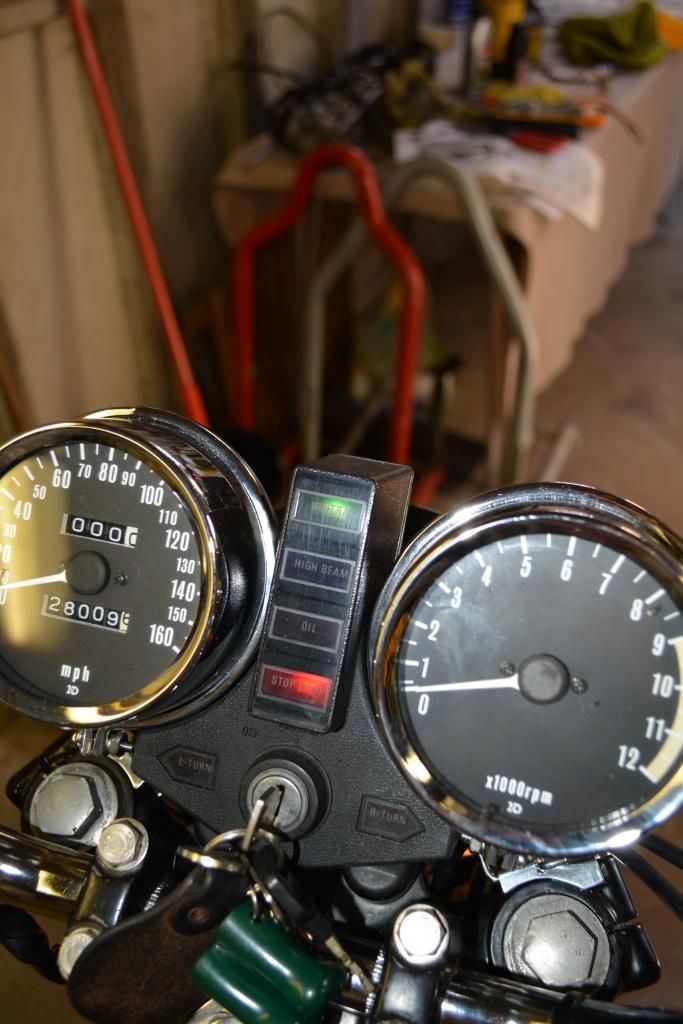

Everything seemed fine at first, front brake lever now lights up the brake light, rear brake lever lights up the brake light as per normal, headlight working, high and low beams working fine - but, as soon as I switch on the headlight the brake warning light on the console lights up and stays on until I switch the headlights off again and neither brakes light up the rear lamp and the indicators don't work until I switch off the headlight again.
Indicators and hazards (US import) also work fine.
There is a brown and white wire which is sitting idle, not sure what that's for.
Any ideas where I'm going wrong here?

#2 PostAuthor: z1bman » Sun Jun 02, 2013 4:58 pm

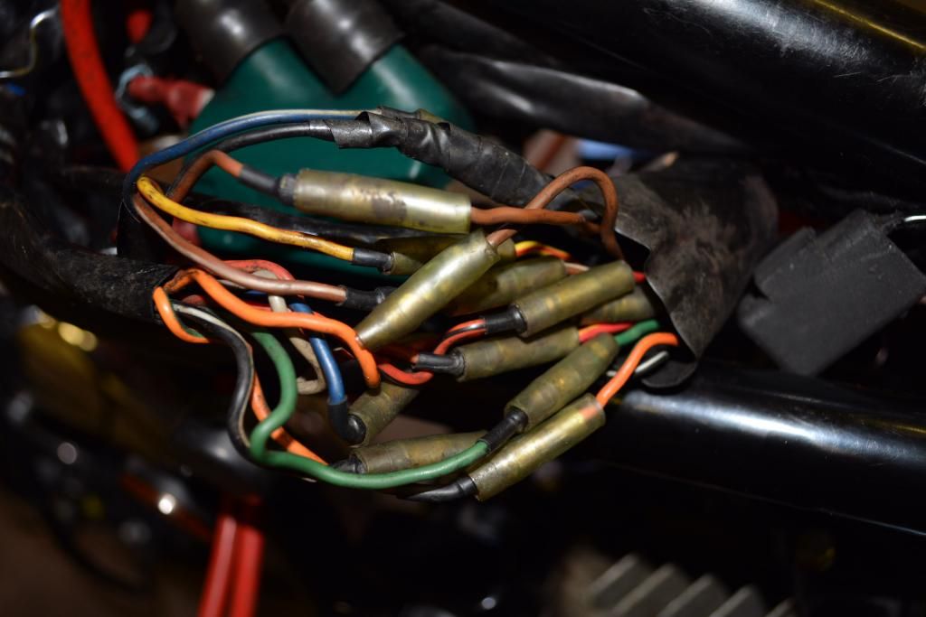

TRY DISCONNECTING THE OUTAGE SWITCH UNDER THE FUEL TANK IT FITS ONTO A SMALL BRACKET BY THE COIL+ IS ABOUT 2 INCHES LONG + HAS A BLOCK CONNECTOR WITH 3 WIRES YOU CAN SEE IT IN YOUR PHOTO OF THE WIRING UNDER THE FUEL TANK

#3 PostAuthor: JohnC » Sun Jun 02, 2013 6:24 pm
Hi again z1bman, yes disconnecting the outage switch (kind of) resolves the problem but as you probably know means I don't have the brake light working from the front lever. I often wondered what this wee doofer was for :)
The plastic block connector always looked a bit fried / melted, but I never bothered with it as I never had a brake light working from the splitter anyway.

#4 PostAuthor: PAULJAC47 » Sun Jun 02, 2013 6:29 pm
Outage relays are a bit like Hens teeth i am afraid..and expensive when you find em(used),once had a circuit diagram produced for one ,more to it than you amy think!

000zeds
Posts: 1129
Joined: 30th Dec 2005
Location: Kent
#6 PostAuthor: 000zeds » Sun Jun 02, 2013 6:53 pm
Can the outage switch not be by-passed :?:
I thought it was just to inform you if your brake light bulb is blown :!:
Zeds-R-Us
PAULJAC47
Posts: 3266
Joined: 31st Aug 2008
#7 PostAuthor: PAULJAC47 » Sun Jun 02, 2013 6:57 pm
You are correct it should make the brake light idiot lamp pulse on/off if filament has blown in brake lamp...
