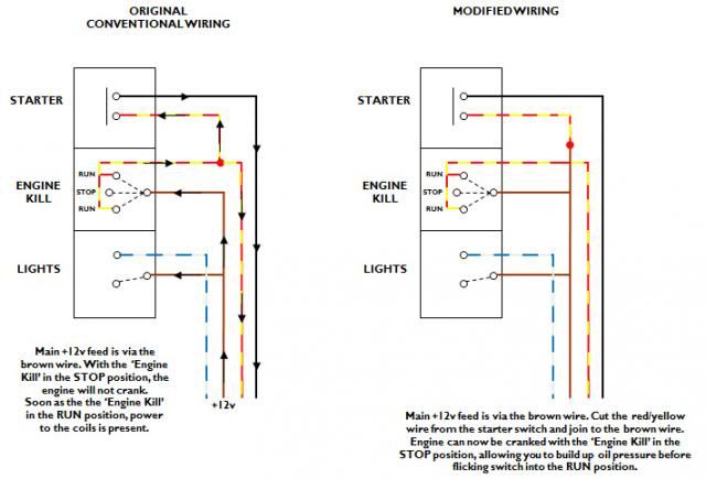

#12 PostAuthor: Big Fluff » Tue May 28, 2013 12:22 pm
If there's nowt at the red wires on your coils with the ign ON and the kill switch in the RUN pos'n, then check the brown wire going into the RH handlebar switch, that shouls have 12v which then supplies power th the kill switch.
Look at the LH pic of this and follow it through.
Will
Kawasaki H2C 750, ZRX1100R, H**** VF1000RG Rothmans, H**** VF500F2F, Suzuki GSXR750F Slabbie
