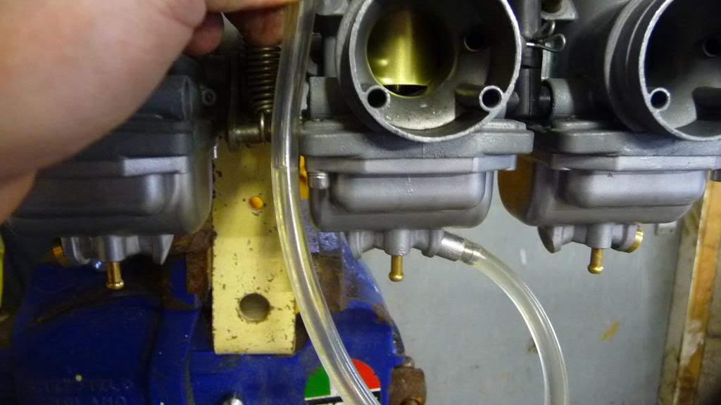

I think this is correct height if I am reading the manual correctly?

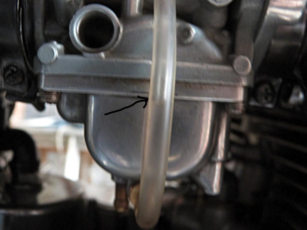

#2 PostAuthor: DogsbolloxofZ1B » Fri Apr 12, 2013 6:29 pm
That's correct with bike on centre stand level ground.

#5 PostAuthor: Rich » Sun Apr 14, 2013 5:50 pm
correct place but it should be taken at the bottom of the meniscus
