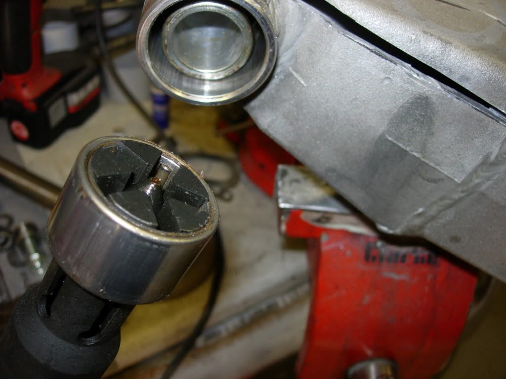

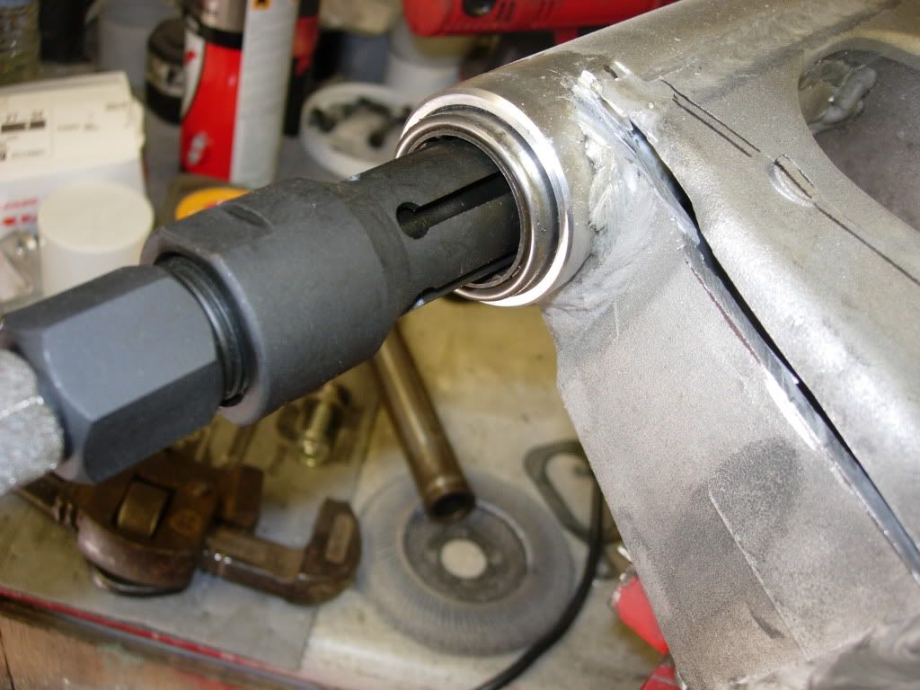

I was introduced to a bearing puller + slide hammer by young Coldsummer......
Fantastic piece of kit & not that expensive. :up

Looks really good Ginger Bear , can you point me in the direction of stockists please
