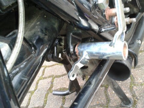

I've been labouring to fit the brake side Tarozzi rearsets I've bought for my 1978 Z1R. Whatever I've tried just hasn't worked.
The supplier is being as helpful as possible and has offered a full refund if want it, but I'd just rather resolve the matter and get them fitted. To this end the supplier (Discovolante) have asked whether I'd be interested in working through the problem so it can be resolved for me and any other unfortunate soul trying to fit these rearsets to a shed in the future.

Tried that
Hi Steve
I took the rocker to an engineering shop who were unable to take 6.5mm out of the middle of the rocker because of the way the rocker arms are located, so they took 6.5mm off the frame end of the rocker and rewelded the master cylinder actuating arm back on. Unfortunately, the rewelded arm no longer lines up with master cylinder pushrod and the pedal linkage now interferes with footrest mounting plate. It turned out to be a right dogs dinner.
Thanks for your interest. I'm back to the drawing board!
Fred

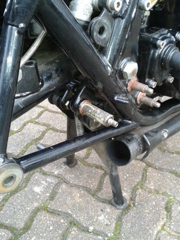

that all looks right around the brake pivot the RAASK system is kinda the same but the actuator rod is kinked and offset to miss the frame looks like that should be the case for those as well is that rear pivot the result of the "butchering"?> cos it looks toooo short wheres the pictures of everything fred? gives us a chance to eveluate a bit better

Pivot
Hi Keith
The photos were taken pre-butchering (thankyou!)
I'll post another topic up to see if someone can take a photo of a Tarozzi rearset fitted so I can see what it should look like
Fred

No offence taken!
Hi Keith
Sorry mate, I didn't mean it as a rebuke (I'm not like that at all). I appreciate your help, I really do.
The arm from the pivot that is connected to the brake pedal is about 6-7mm out of lateral alignment, which is why I had that amount machined off the other end of the pivot... then I found that arm rubbed against the rearset mounting plate (Doh!)
It's a right head scratcher!
Fred
