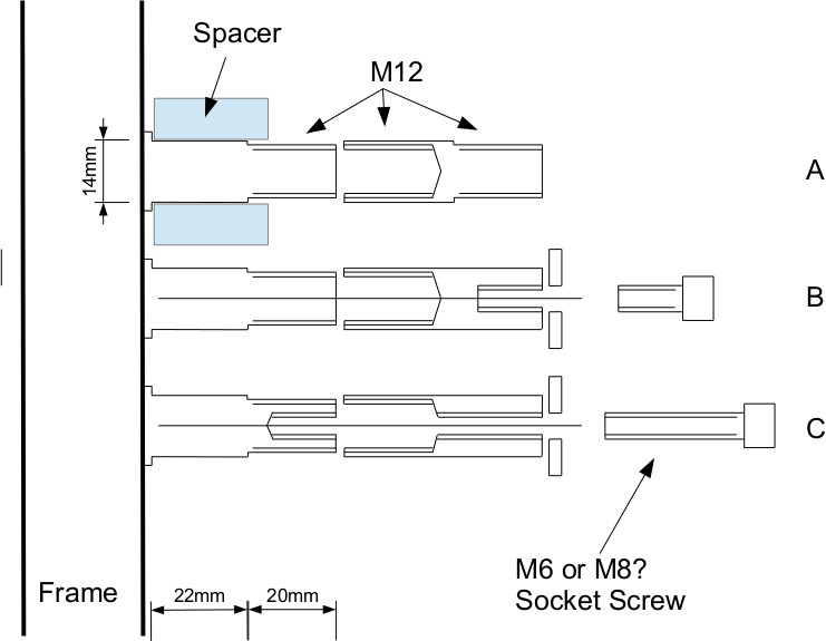

#8 PostAuthor: ruffle » Sat Mar 30, 2013 3:28 pm
Rather than installing new mounts I was thinking more of extending the existing ones.
Rough measurements with a tape measure suggest that I need to space out the shock top mount by 26mm each side but I need to do some 'proper' measurements and the length of the spacer and extension in the drawing is therefore not to scale.
'Scuse the drawing; last did any technical drawing in school with a quill pen and gas lighting :)
Option A allows the fitting of a normal domed nut but I don't really like it as there's an obvious weak point.
Option B has the same weak point as A.
Option C reduces the weak point (I think) as the Socket Screw goes into the existing mount. If I use an M8 grade 8.8 or 12.9 the shear strength is measured in tonnes (if I've googled correctly). The mount can be drilled and tapped by using the extension bitty as a drilling/tapping guide.
This 'bolt on' solution also appeals as I can make the above in my lathe but my welding skills are dire :(
However, I'm a software engineer not a real one so opinions of those wot know about these things are most gratefully received.

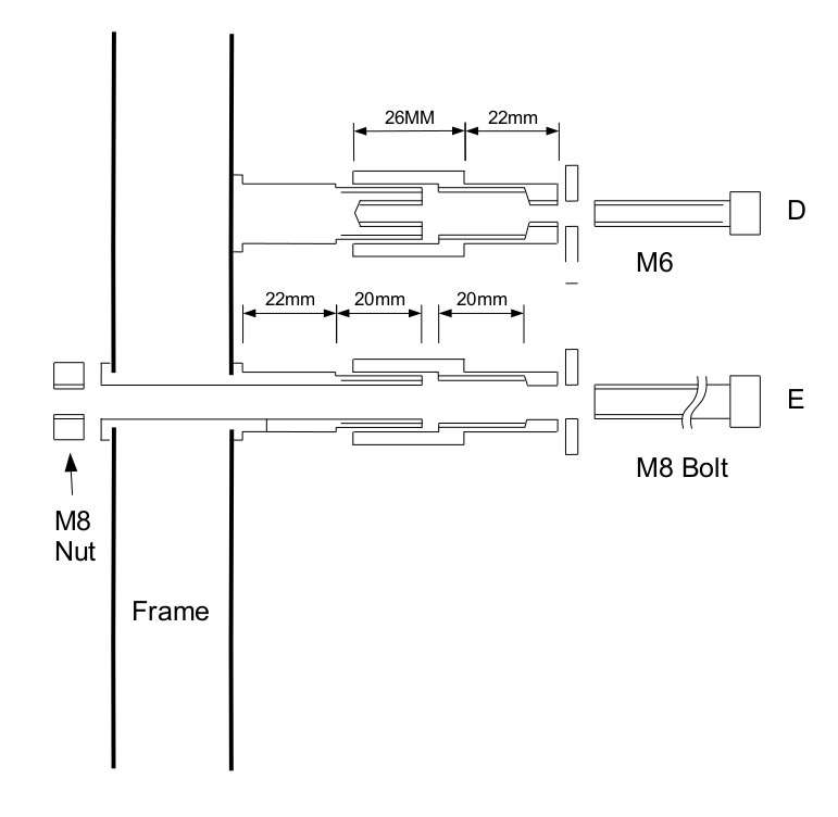

#9 PostAuthor: zed1015 » Sat Mar 30, 2013 3:38 pm
I would possibly go with 'C' but incorperate the spacer as in 'A' so the whole thing is in one piece which will increase the overall strength and spread the load over the maximum area.

#10 PostAuthor: ruffle » Sat Mar 30, 2013 4:59 pm
Aha! Ta Muchly. You mean like option D below?
Option E (drilling all the way through) did occur to me but I think there's too much potential for the drill wandering (it would be a handheld drill) so Option D looks like the favorite.
EN1A steel be OK do you think?

#11 PostAuthor: harrythemagnum » Tue Jul 29, 2014 11:07 am
From another post, I was looking to make up some shock extensions for another member, the ones on my bike are similar to option A, initially looking at the drawing was concerned I had made something unsafe.
But help me out here, isn't the shock force still acting on the original mount, granted on the end with a sleeve over the threads, the extended thread is only for the nut to stop the shock sliding off, I don't think I would risk a carry rack but a grab rail should be ok?

#12 PostAuthor: garyd » Tue Jul 29, 2014 11:38 am
Purely from an uneducated view...
I very much doubt that anything would shear.
But there is obviously an increase in load at the point where it meets the frame purely due to force being applied further away along the same size bar.
But as I've never heard of these mounts ever giving any trouble...even in crashes, I'd suspect the extra load is within safe parameters.
Any professional mathematicians care to work out some moments of force?

#13 PostAuthor: Padders » Tue Jul 29, 2014 12:29 pm
Option A would be fine for me no worries

Padders wrote:Option A would be fine for me no worries
And me
