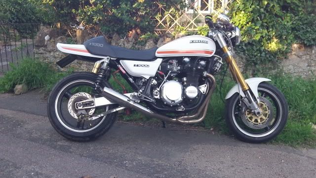

Keith, not the best pic, but I fitted some Harris rearsets, using a very simple triangular ally plate.
The plate bolts to the existing footests mounts, the top rearset mount, bolts through the plate to the frame, then the lower bolts to your new ally plate.... Simples. :P

Hi Keith... how are you getting on with your plan? I'm done with trying to fit these bleedin' Tarozzis, so I'm looking for an alternative just like you. I liked Ginger Bear's Harris and adaptor plate set up as it does away with that monstrosity of a rear m/cylinder and all the levers, arms and springs.
