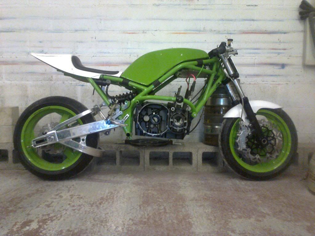

#4 PostAuthor: Pigford » Sat Mar 23, 2013 2:17 pm
I got standard ZZR1100 RWU forks on me Harris - but dunno what that'll do to the handling as I've probably fook'd it up with the JMC anyhow :lol:
