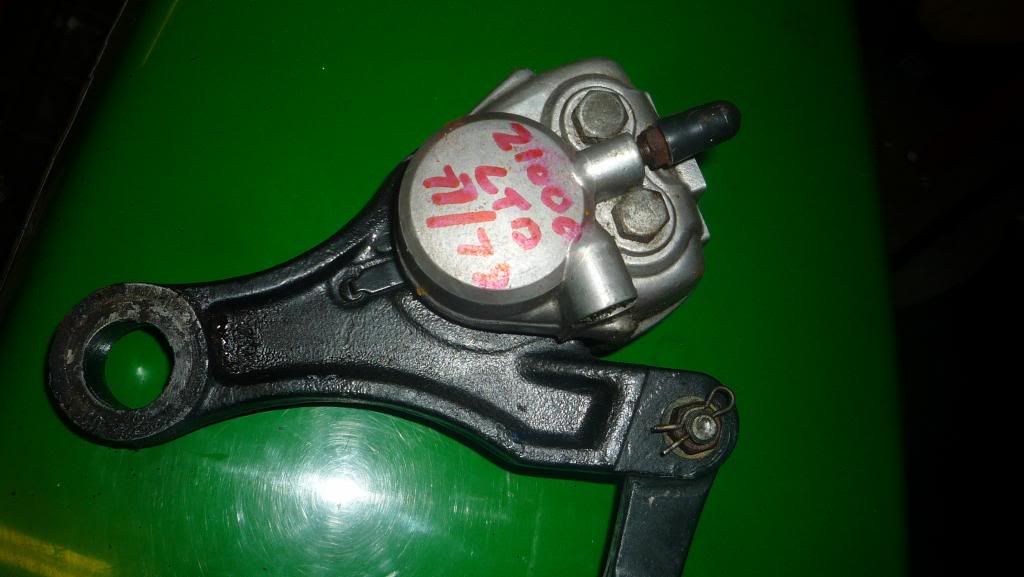

#8 PostAuthor: z1000puddin » Mon Feb 25, 2013 9:24 pm
Nigel,
Yes the rear caliper is a lot different , I have one on the shelf pic below.
I better keep on looking for a rear A1, A2 disc or Z1R I think are the same.

#9 PostAuthor: nigel bessant » Mon Feb 25, 2013 9:44 pm
Stu, that is nothing like the caliper I had on my ltd. mine looked like a Z1R caliper.

#10 PostAuthor: z1000puddin » Mon Feb 25, 2013 9:57 pm
Its the z1r calliper that I have on my thou.
Zed til Dead

#11 PostAuthor: nigel bessant » Mon Feb 25, 2013 10:15 pm
Yep, that's the one. I don't know if it worked with the smaller diameter disc as I never rode the bike. :lol:

#12 PostAuthor: z1bman » Mon Feb 25, 2013 10:34 pm
z1000puddin wrote:Nigel,
1977/1978 z1000 B1/B2 ltd uses the above calliper. 1979/1980 z1000 B3/B4 uses the z1r type calliper
