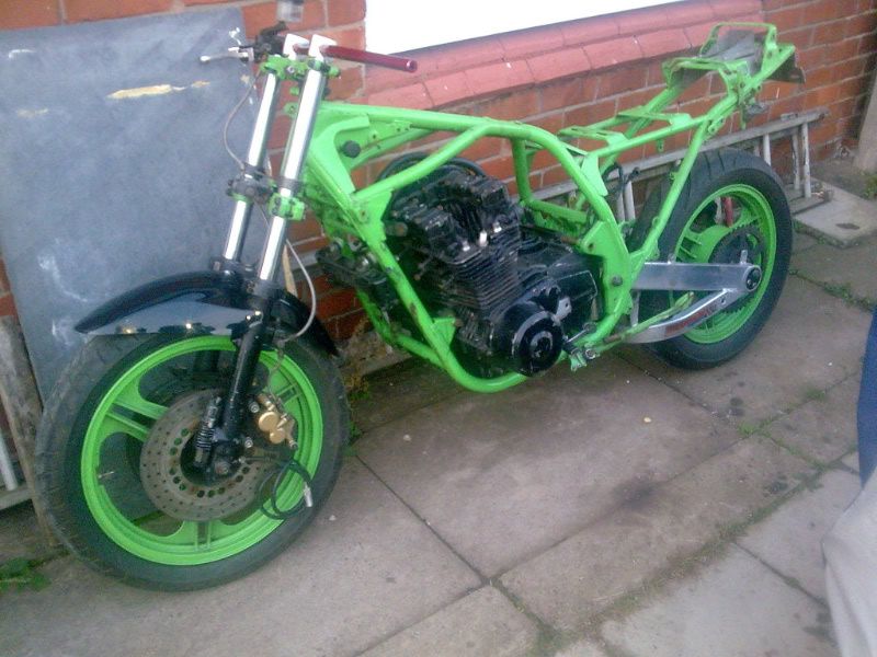

Ive gotten myself a gpz750 uni trac,with one knackered caliper on the front. Does anybody know if any more modern brakes will bolt onto the forks? Im not sure off hand of the measurements,as the bike is in storage a few miles from home.

I've just measured my uni calipers and they're 72mm between mounting centres .

gpx calipers will fit with a little adaption to the mounting bracket

Steve,I need to go see which side is damaged,and I shall get back to you. Fitting a replacement sounds a bit quicker than messing on with other parts.
