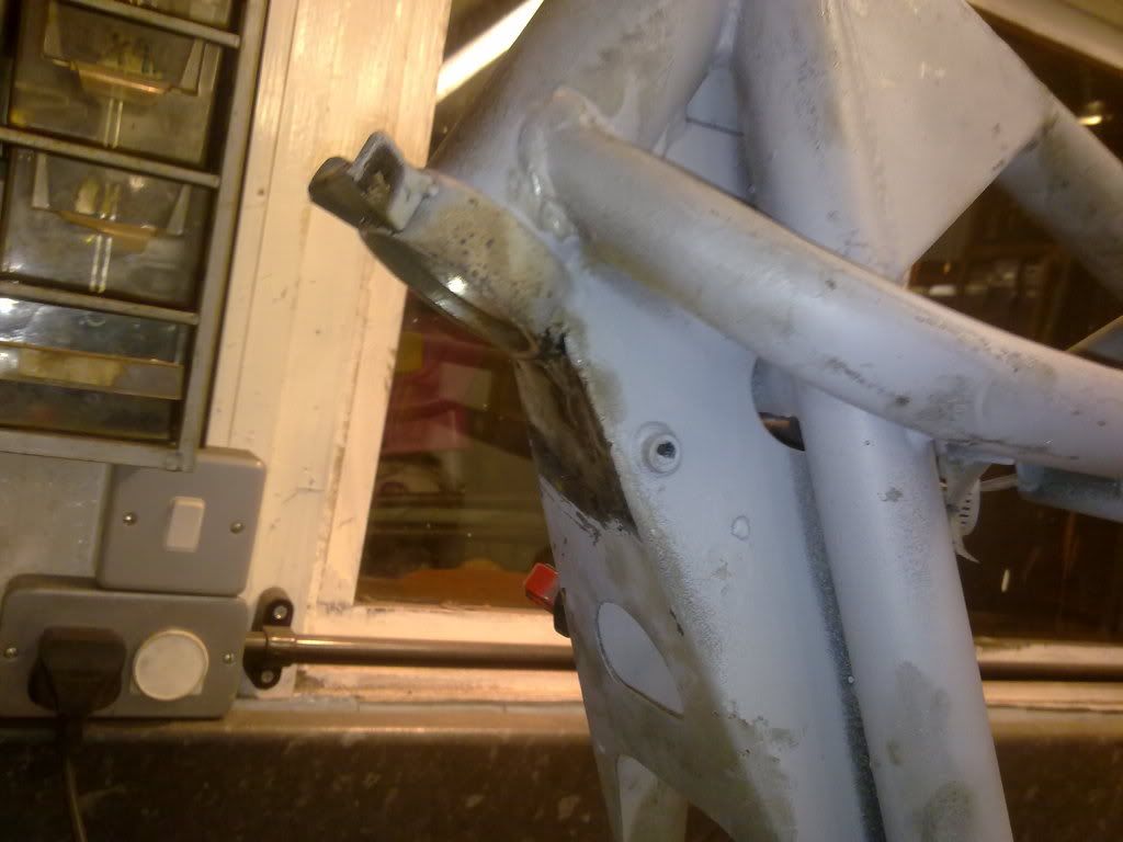

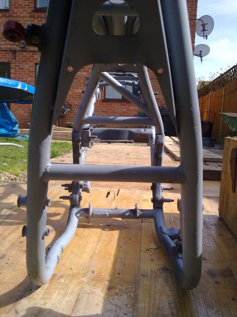

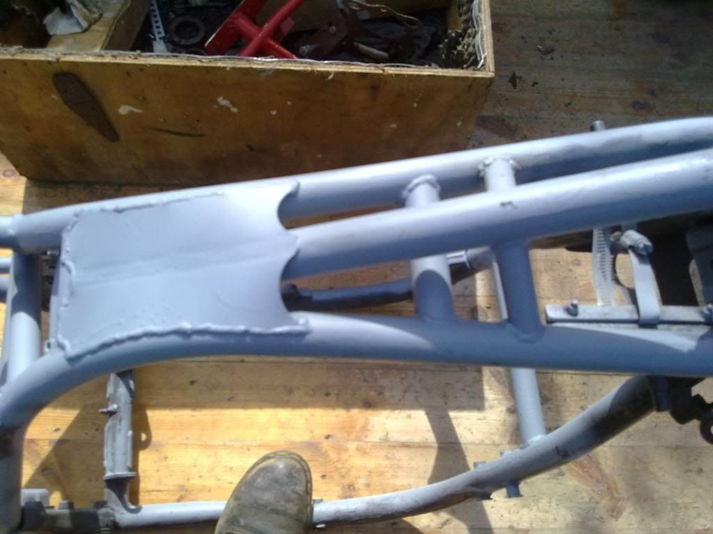

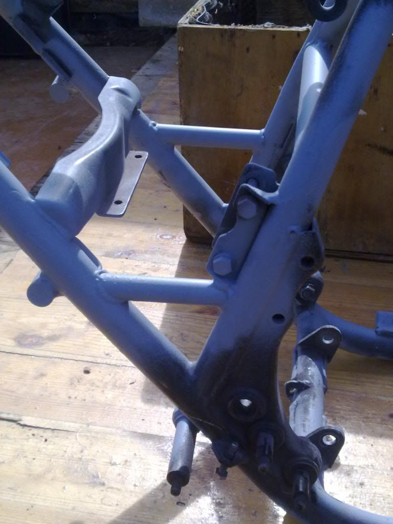

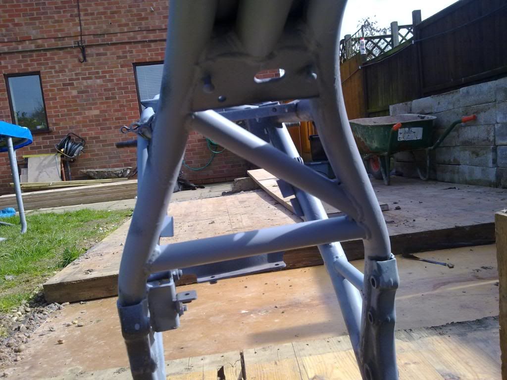

Does it matter much what type of steel tube I use to brace my frame?
The spine has already been done, but not the swingarm area and the cradle front and rear cross pieces.
What should I use?
