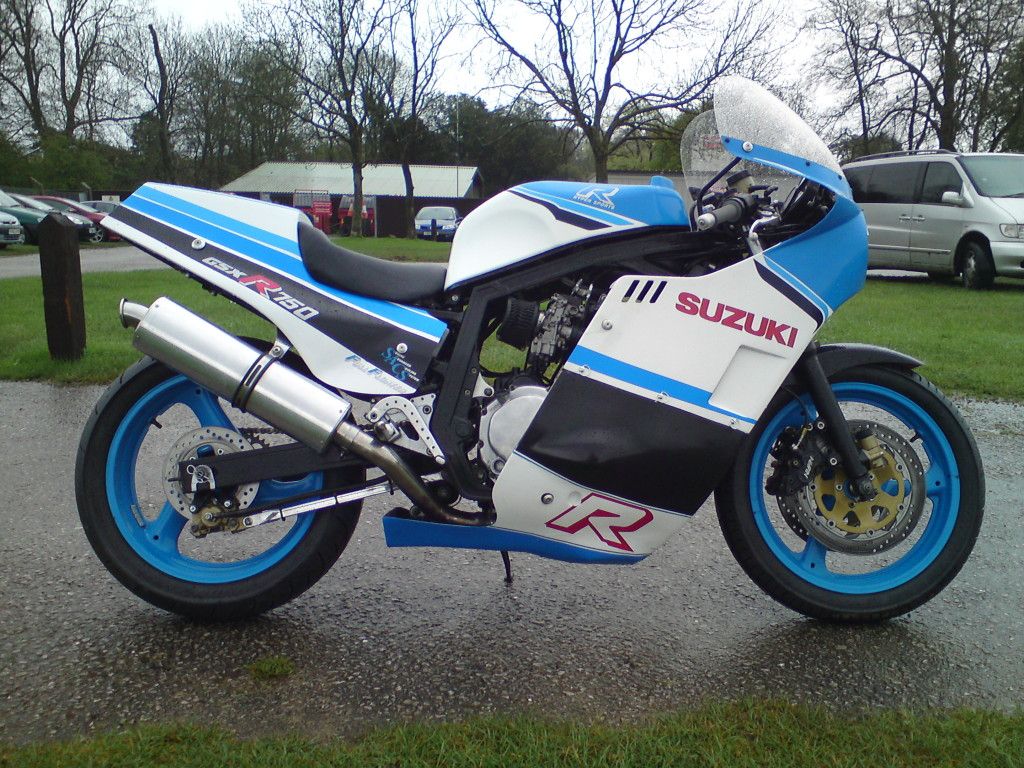

#7 PostAuthor: KWACKERZ1 » Thu Oct 18, 2012 9:12 am
Common 18" wheels are the slabside gsxr wheels, relatively cheap and readily available.
This pic shows a slabbie rear and a j front.
Less common 18"'s are the Slabside 1100 j ones. Better shot of the J rear.
With both j wheels in.
18" wheels are sought after by the classic race boys but a mate might have some slabby wheels for sale H pattern ones if they would help you.
