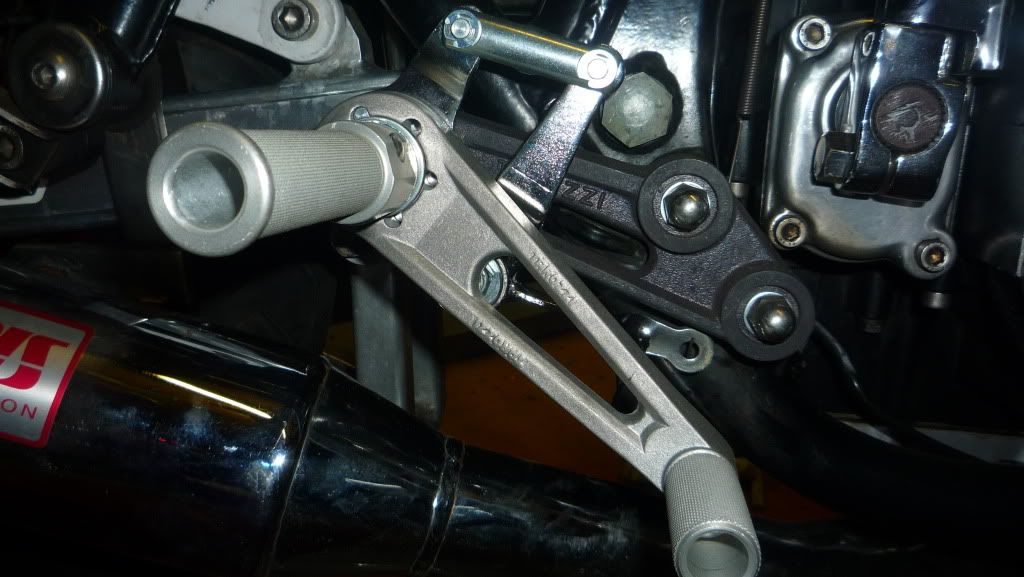

#8 PostAuthor: z1000puddin » Thu Aug 16, 2012 6:48 pm
This any good ?
Zed til Dead

#9 PostAuthor: martinz1000r » Thu Aug 16, 2012 7:34 pm
z1000puddin wrote:Image
This any good ?
Can you photograph the master cylinder and how that is mounted? Thanks

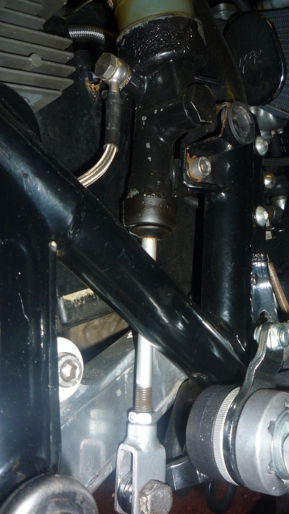

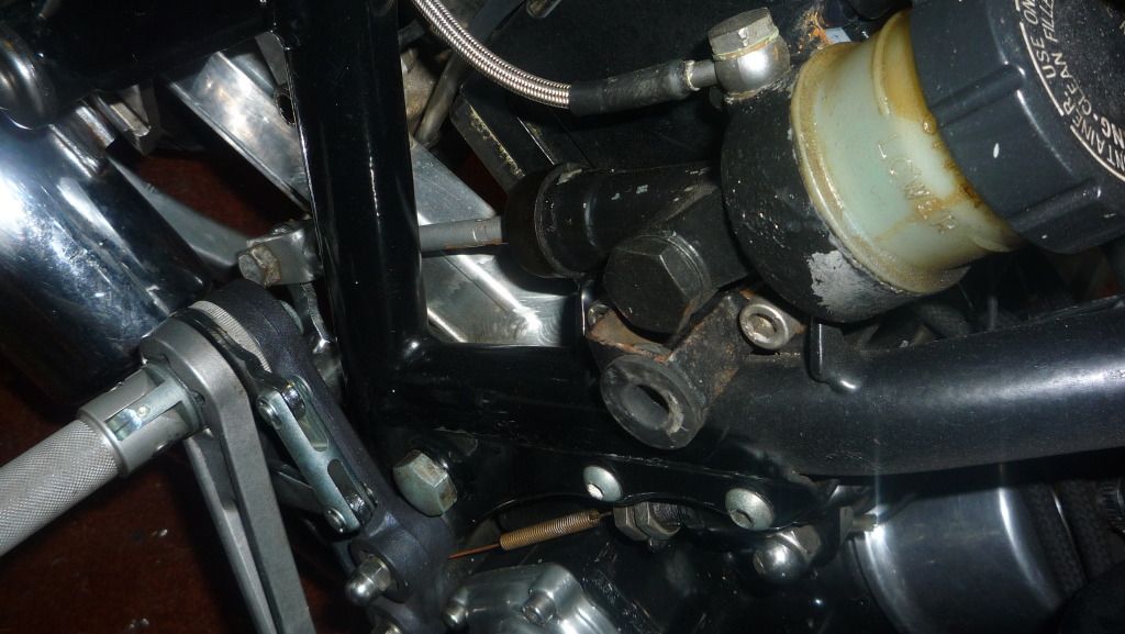

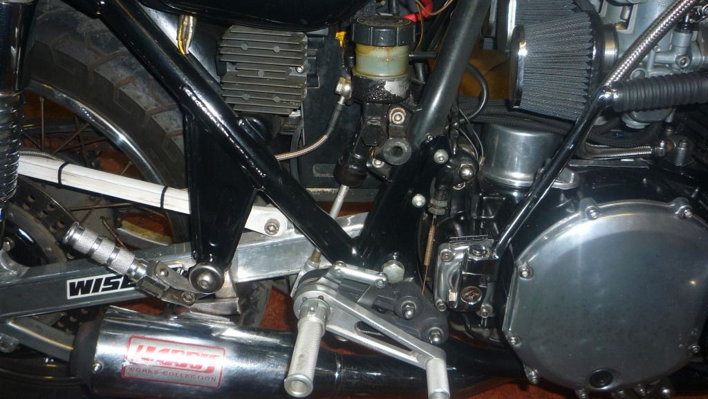

#10 PostAuthor: z1000puddin » Thu Aug 16, 2012 8:29 pm
Martin,
I will post a pic later ( camera is playing up)
But to let you know, I used the standard z1000a1 reservoir with the standard rod, which connected directly to the tarrozi supplied bracket.
The rod clevis was very tight as I have a metmachex swingarm, but it did all fit in the end.
Stu

#11 PostAuthor: z1000puddin » Fri Aug 17, 2012 7:24 pm
Martin,
Some more pics - Hope this helps
stu

#12 PostAuthor: martinz1000r » Sat Aug 18, 2012 4:01 pm
i think I have managed to sort a solution. I found an old Brembo master cylinder and and mounted that to an alloy plate. It seems to work but now have not got a suitable pipe. Special thanks to Z1000puddin for the photos.
