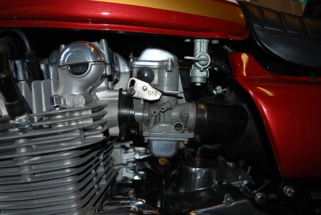

OK, here are a couple of pix just to save any confusion.
Side on (taken from same side)
From underneath (taken from kerb side)
As you can see, the screw is towards the engine.
Does this mean, as you've said, it's in to weaken?
Bongo.
"Keep on Rockin'!"
Posts: 13314
Location: North Dorset
#4 PostAuthor: Pigford » Sun Aug 05, 2012 5:53 pm
YEP.... thats a fuel screw - so in to weaken :wink:
