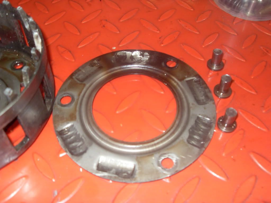

I've stripped the clutch hub down ready for an APE re-build kit but the inner plate has deep ridges in it from the hub springs. Are the plates available? Or can it be repaired in some way? I thought maybe the ridges could be filled with weld and ground back?

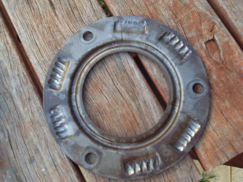

This one was removed from a 73 Z1, as can be seen had been weld up and ground out at some stage and others are worn, but believe me it did not rattle and preformed as normal, it was replaced in an engine rebuild, other wise would still be on the road today.

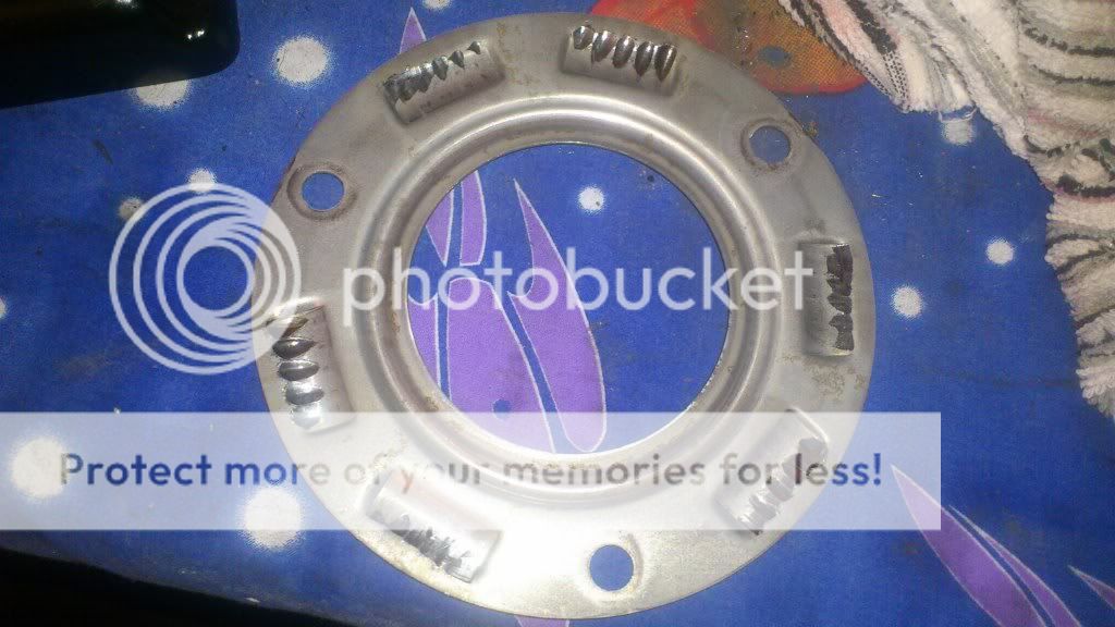

This ones otta my Z1B, It was then tig welded up, gound out and still going fine today after about 2,000 miles.
