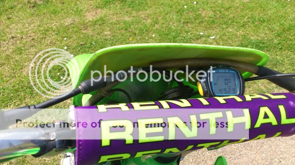

I had my KX500 supermoto MOT'd in January. It had a push bike speedo, but the examiner told me you don't need one fitted at all for an MOT. He also said you don't actually need a number plate fitted either! :?: He put mileage down as zero.
Image[/img]
