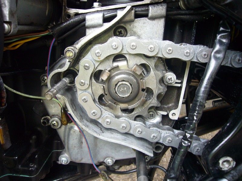

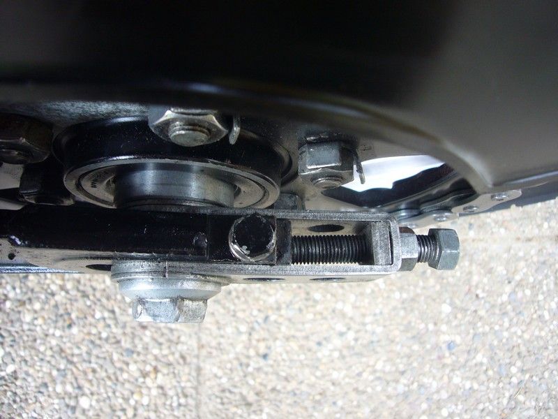

Can anyone tell me what chain length and sprockets they are running on a B2
with original wheels and swing arm. I thought I had everything original (front sprocket 15T rear sprocket 40T ) but the new 630 chain, 98 rivet ( 49 side plates )is nearly at the end of its adjustment so something is not right !
Any help would be appreciated.
Richard

Richard i dont know the answer but this may be of more use.
If that chain was one link shorter you wouldn't get it on.
There will be a short period of bedding in which will require a few mm's of adjustment which will take it to the limit of travel.
Four years of thrashing, wheeling, sprinting and other un-mentionalbles by myself and others has not managed to put the chain where it needs any more adjustment.
My last (630) chain i had to run baggy for a year before i could take a link out of it. Previous experience told me that replacing the link on a chain as old as that was not going to be practical so i replaced the chain. By then it was about eigth years old.

You are right about a shorter chain I have a 96 rivet one which will absolutely not stretch onto the sprockets. Your comments about the longetivity of a 630 chain are useful , I just wondered what was there in the first place when the adjusters are right back at the beginning of their travel.
It is not a big problem and doesn't stop me riding so never mind.
Richard
