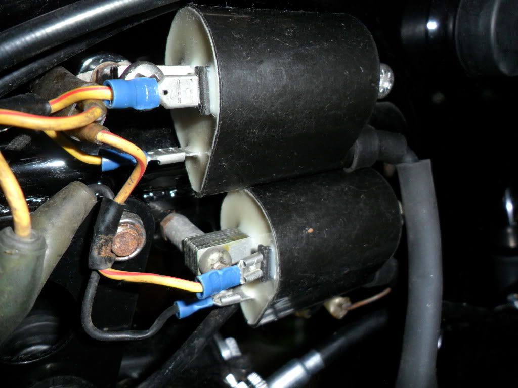

Hi guys, I have got two new coils for my Z250, they are patten of course, every penny helps, my prob is the new coils have two spade connectors on them, the original ones had two wires built in with colour coded bullet connectors, one of the spades has a little black plastic pad on them, my question is does it matter which wire from the condenser or the points go on which spade? if you get my drift :?:

#2 PostAuthor: kev edwards » Fri Apr 13, 2012 7:44 pm
yes it does matter i should imagine the spades with the plastic caps on them are the common connection and the the other s being the ones from the condensors, pics of the new coils may help

#3 PostAuthor: DavidZ1R » Fri Apr 13, 2012 8:11 pm
http://i1123.photobucket.com/albums/l55 ... ils001.jpg
Hope this helps, I have jointed and reused the old coloured cables to fit the existing bullets.

#4 PostAuthor: DavidZ1R » Sat Apr 14, 2012 3:59 pm
Sorted now, contacts lead goes to the spade with a lug cheers.
