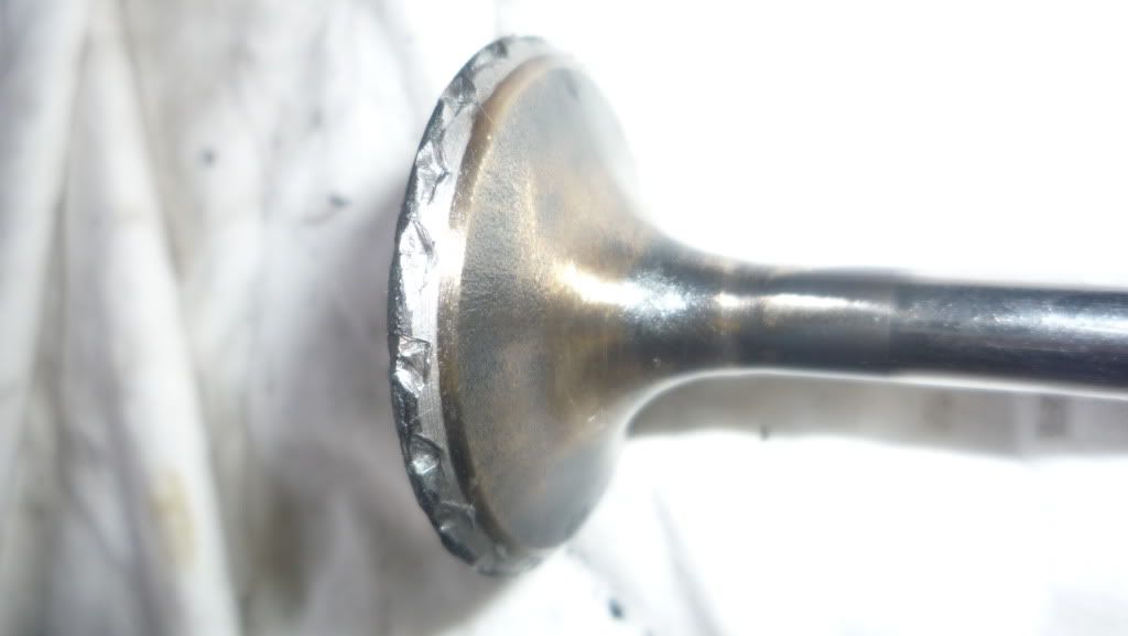

Do it right & whip the head off.
I used these http://www.timesert.com/AFTER I tried the grease way.
I will try & post a pic of my valve once it chewed up a small fragment that the grease did not catch. (Not a pretty sight)
