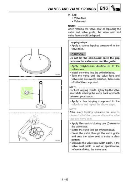

Gentleman, I'm just about to refit valves to refurbished head (APE guides and seats recut), I know oil is supposed to go on these bits, but considering it's a full rebuild with engine super dry (cases blasted etc) should I use moly lube on valve steams ? Asking because that's the way to go as per my WR450 manual printed in 21st century, so maybe world has gone step forward ? Cheers

Thanks for the replies, I have BELLRAY assembly lube which is molybdenum based so will use it, but that GRAPHOGEN seems to be good stuff.
I'm also fitting new Wiseco 1075 pistons and bored/honed cylinders, am I right to think lubricating these with anything better than mineral oilt would prevent rings bedding in ? I was mostly concerned about lubricating valve stems/guides and cam lobes, here is WR450 manual screen that made me seeking advice here :
