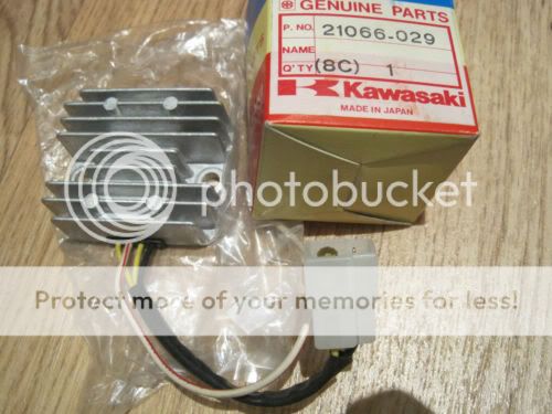

Hi Folks
My Z650 is wearing an original Shindingen REG/ REC unit which is marked on the factory sticker as
SH521 - 12 2.3
Just got hold of a new spare which came in box with right part code (21066-029) and looks identical - but sticker is marked -
SH521 - 128 8.2
Are the two units interchangeable - I am guessing they are both SH521 model but is the rest a date code or what?
It doesn't look like the 8 has been rubbed off the original one.
Can any wise men on these units please enlighten me??
Thanks from Mark

#4 PostAuthor: pertonpc » Wed Feb 15, 2012 7:45 pm
Thanks Garn
They are both 4 wire units and size/ fitting holes matches exactly.
Three wires in a block connector go to the generator and a white wire with red stripe comes out on a bullet connector into the loom.
No earth wire - does that mean it gets earth through the electric panel it is bolted down on??

#7 PostAuthor: Rich » Thu Feb 16, 2012 4:59 pm
SH means shunt - the newer FH ones are Mosfet. looks like single phase the black should be earth, yellow connects to the alternator and red/white out put. NO voltage sensing. 521 is the model and current handling code - 12 is for 12V and the other n=bits are probably just batch codes.

#9 PostAuthor: GUYZED » Thu Feb 16, 2012 7:56 pm
There you go Mark...some pics of my REG/REC
It does look like a B not a 8 on mine.

#12 PostAuthor: pertonpc » Thu Feb 16, 2012 8:05 pm
Hi Guy
Just spotted your pics thanks.
That's interesting on the sticker - I think what I quoted as "8" could actually be a "B" now you have magnified it a bit more.
