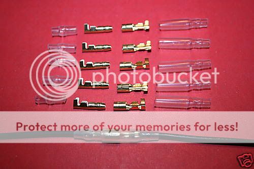

If you buy these bullets off eBay they can be crimped to look exactly like factory loom connections. You tube has a demo.
The correct crimper tool has a little projection in the middle of the clamping area which forces the brass bullet edges back on themselves to give that "folded over towards middle on both sides" effect (see pic).
Anyone here ever sourced one of those special crimpers please?

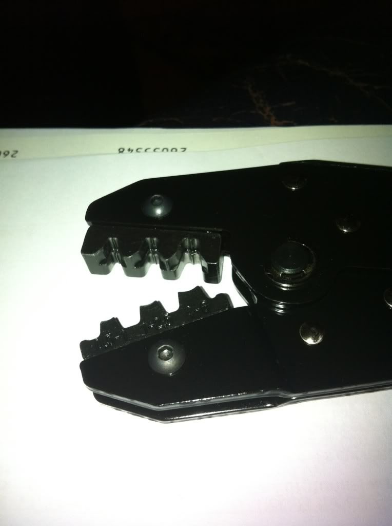

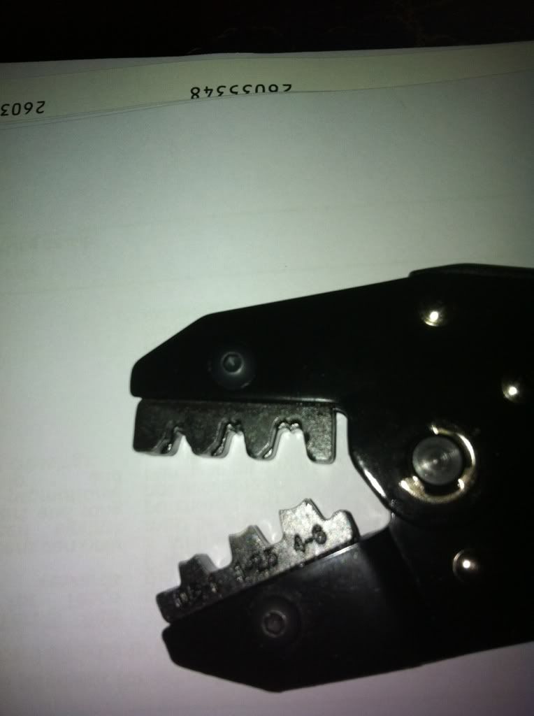

#4 PostAuthor: Taffus » Sat Feb 04, 2012 5:37 pm
pics of my latest one!

#5 PostAuthor: pertonpc » Sat Feb 04, 2012 6:32 pm
Cheers Guys,
Those are the ones...
Who is the supplier you use to purchase these from please?
Mark - why upgrade to the ratchet style - did you find the crimps were uneven with the manual one or what?
What sort of prices can I expect to pay?
Thanks from Mark
