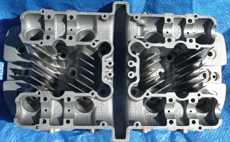

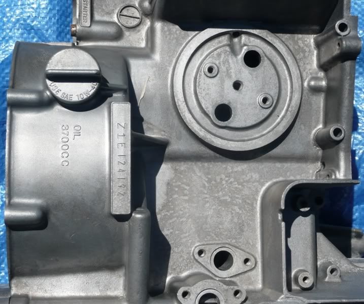

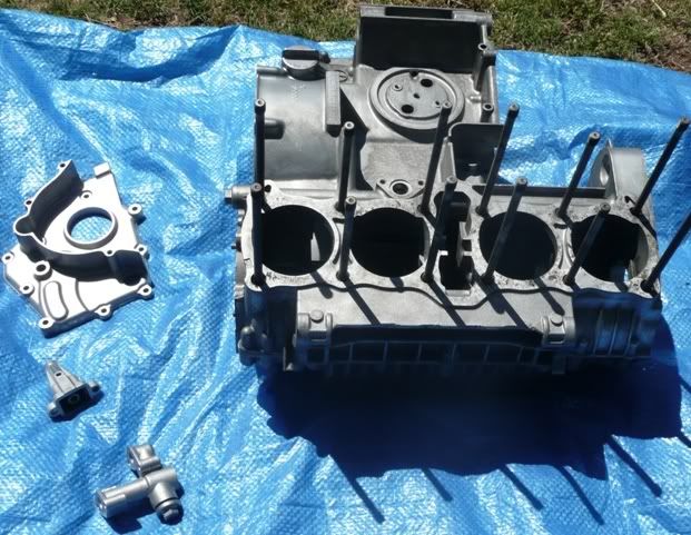

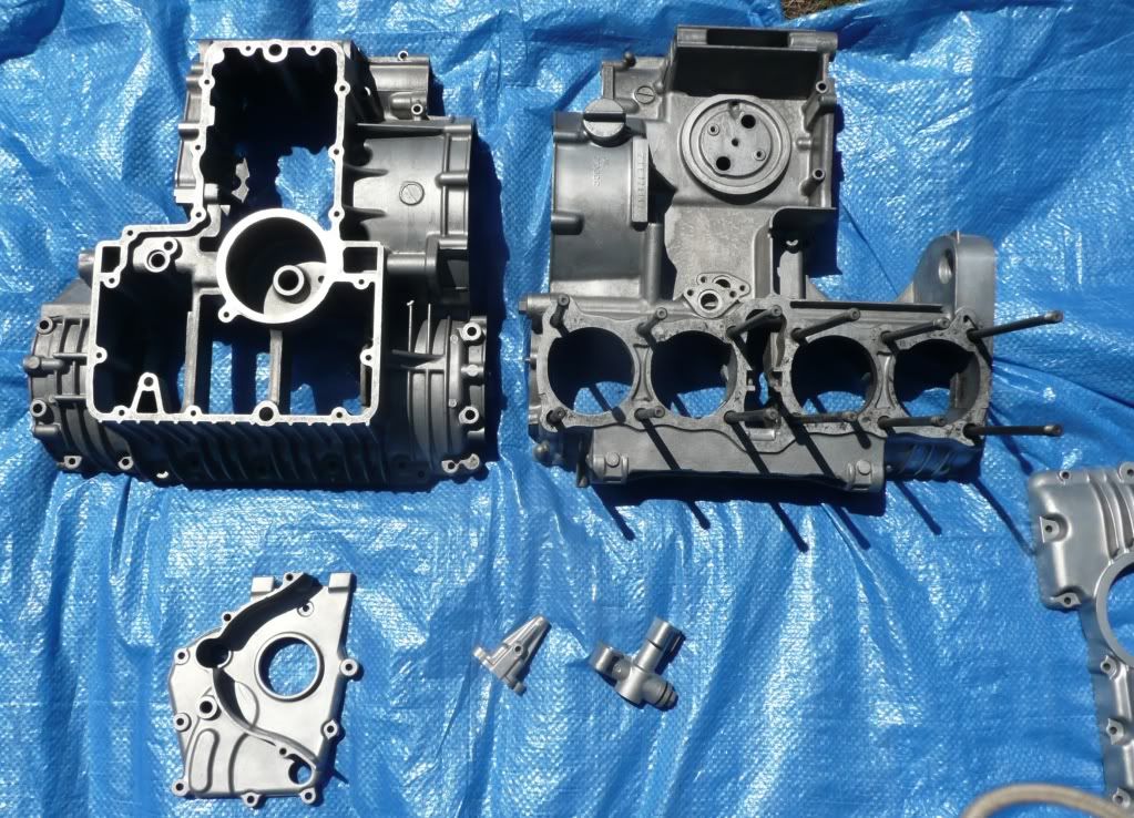

http://i1086.photobucket.com/albums/j458/kennymoyes/b4vb3.jp
#10 PostAuthor: kennym » Sun Jan 01, 2012 12:27 am
Before 3
Before 2
Before 1
after 6
after 5
after 4 white residue - oxidisation ?
after 3
after 2
after 1
Hopefully I have managed to post some b4 and aftrer pics o0f the vapour blasting includiung the whitr residue around the oil filter recess I dont know where to next this nnot at all what I was expecting, the finish is a duller grey than before it was - vapour blasted, any thoughts much apriciated regards and seasons greetings Kennym

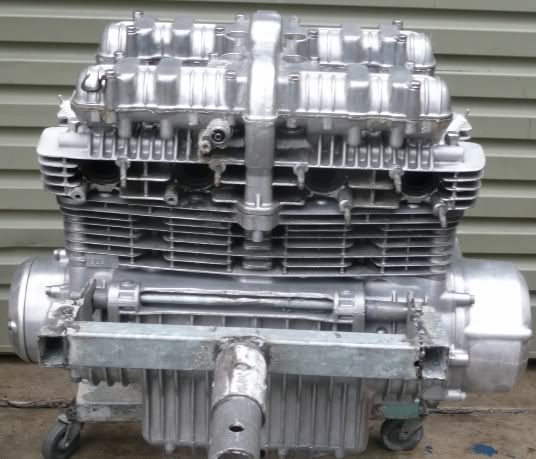

Here's a picture before -
And here's a picture after-
here's a picture of the built engine, were going for 225bhp at the wheels, the mini moke weighs in at just under600kg, should be fun!
Anyway hope this helps, he's a top bloke and does a great job.
