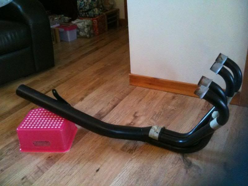

#6 PostAuthor: davy thomson » Tue Dec 27, 2011 9:33 am
Got this from Ebay still not sure if it is a Yoshi pipe but it sure is close,fat headers and 3" dia pipe not many other pipes from that era fit the bill?and it is to good for a home made job.Image
