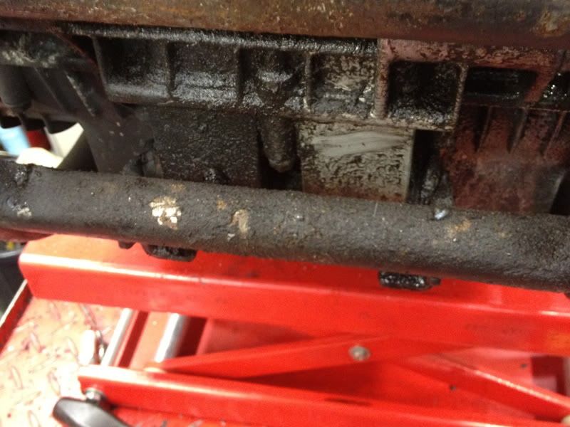

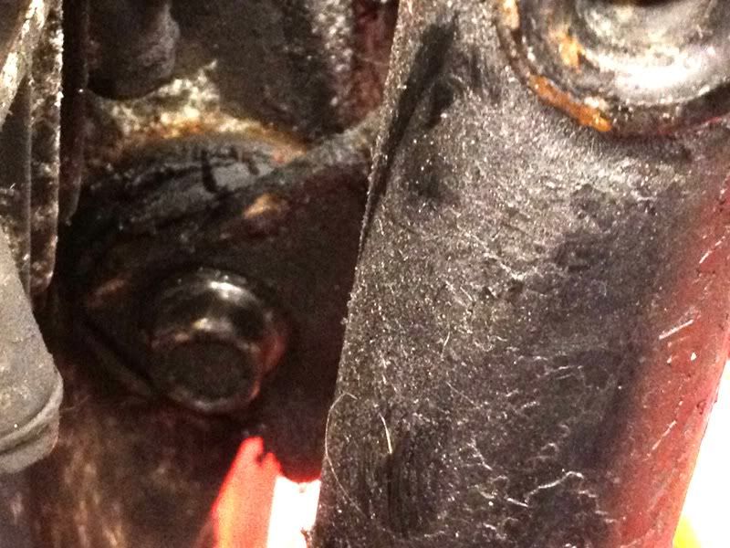

The bottom front engine mount bolt on the Z1100 shafter won't come out. It's one of the rubber mounted jobbies, and I fear that the bolt has become welded with rust to the sleeve inside the rubber mount.
I have tried beating the end of the bolt with a persuader (four pound lump hammer). I don't sea how heat would help as all that's going to happen is that the rubber will catch fire.
I suspect that the only way is to drill the head and end out; but if there is a less destructive method it would be good to hear it :)
Any help much appreciated :D

My Lawson was the same - I kept at it with a lump hammer and it only took 90 mins :??

I have used an sds drill on rotary stop to drive out stuff like this.

Maybe try aheat gun/paint stripper,[ not naked flame ].Take longer to catch alight,might help?

if you have access to an air chisel spray plenty of releasing fluid on the bolt preferably over a 24 hour period then use the air chisel with the straight pointed drift to vibrate the bolt out . i have used this technique on many stubborn bolts. it is very good for removing aluminium exhaust flanges that have seized onto the studs

I Use one of those 14 volt hitachi rattle gun type screwdrivers on things like that and to date they are very successful, and of course i have the high tensile sockets and adaptors to go with it.

Ralph you are welcome to borrow my snap-on cordless rattle gun if you like. It WILL shift it.
