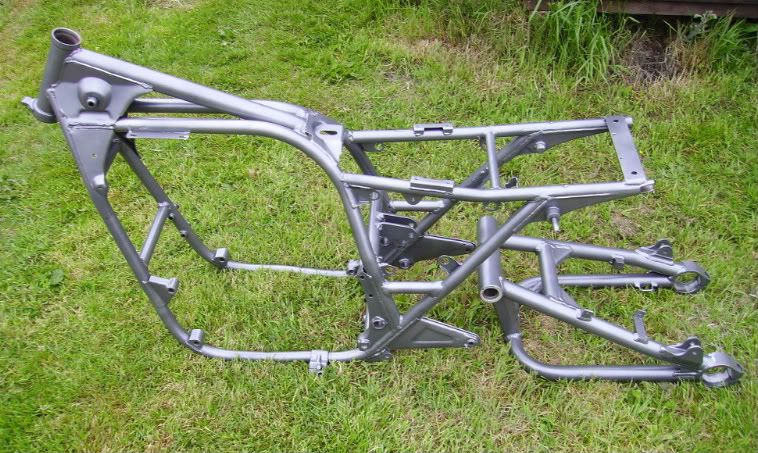

Hi, wondered who has ever played around with Z650 frames, adding yokes, forks, deep brace swingarms, wider wheels etc. What works, whats easy to bolt in etc etc. Crofty

could be useful to start with abit of bracing crofty, especialy with your torquey 810 motor .....heres how mine started out- braced front, back and sides of the engine cradle (the rear brace was originaly the top mount for a monoshock)
