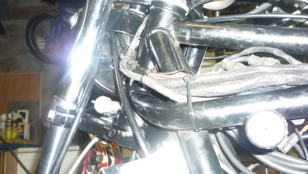

Has anybody got some images of how the wiring loom is laid out on an A1?
I'm restoring an A1 and just about to lay the loom back in the frame and want to make sure I'm doing it right. Pics anyone?

Dogs', sorry I can't help with any pics.
You mainly need to know, that the route is, from the h/light, along the LHS around the air cleaner, noting that the brown connector goes to the LHS, not the RHS, as does the earlier Z1 series. There isn't much room around the air-cleaner, however I'm pretty sure you will see a groove in the air cleaner to accommodate these wires.
Surely some of you Z1000 owners can add a photo.

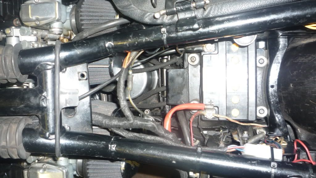

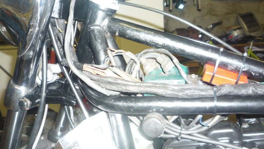

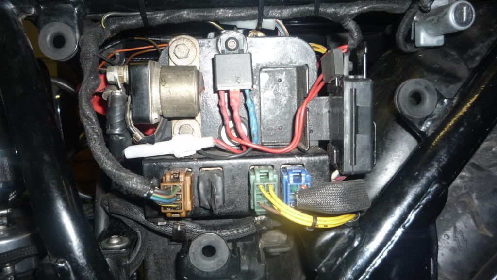

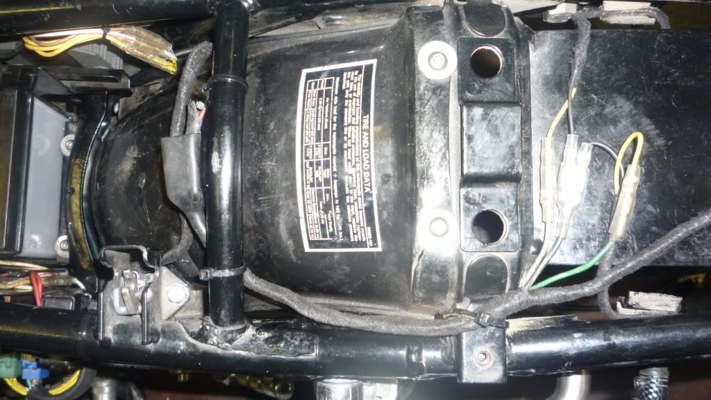

Some pics of my loom,Problem is it is not standard, but it might help
I have fitted a coil repower mod & bike is fitted with a combined reg/rect
