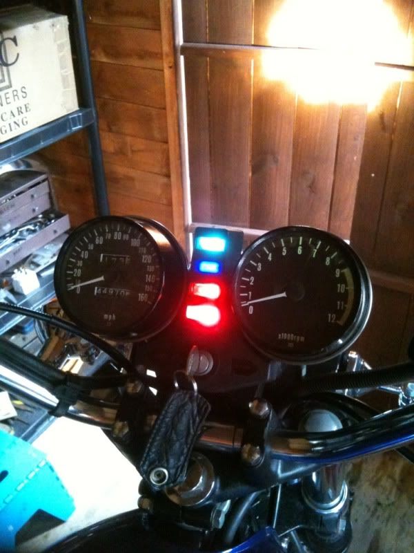

#5 PostAuthor: Mark Tiller » Wed Aug 10, 2011 5:45 pm

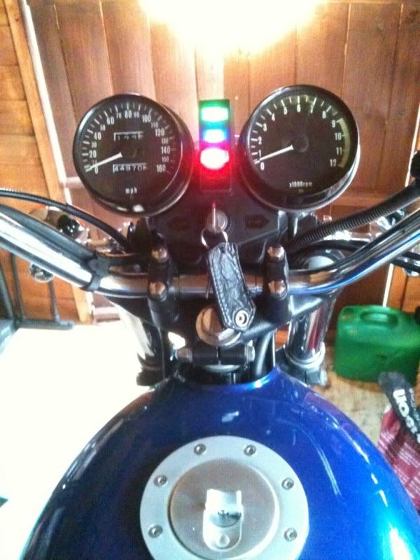

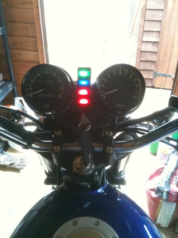

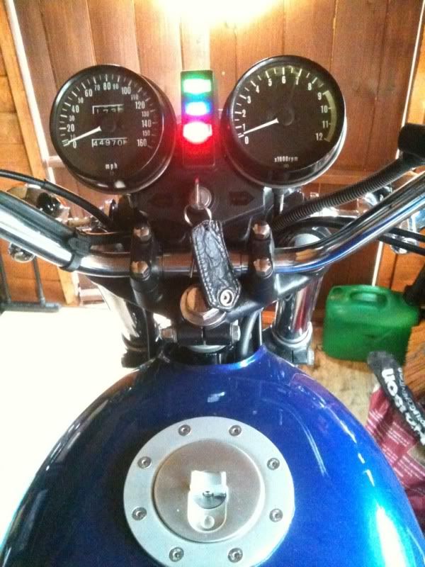

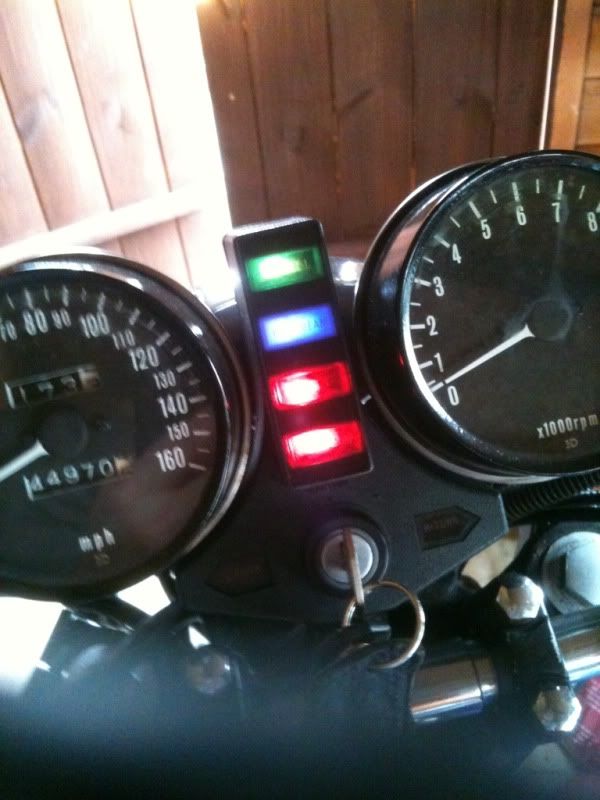

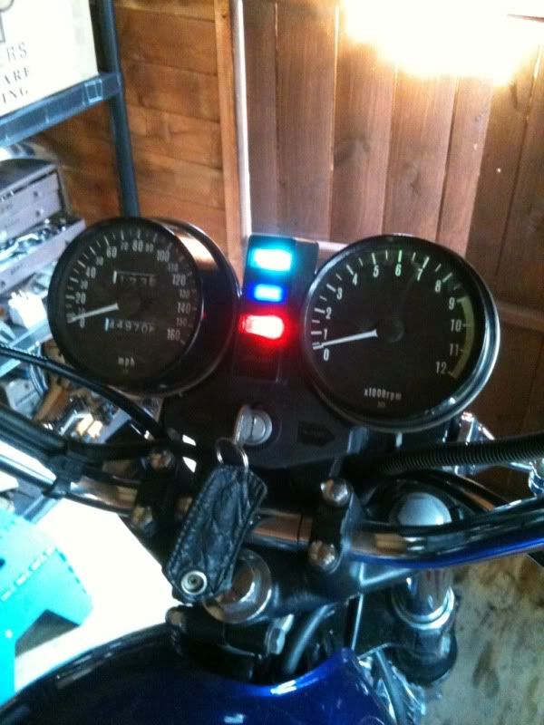

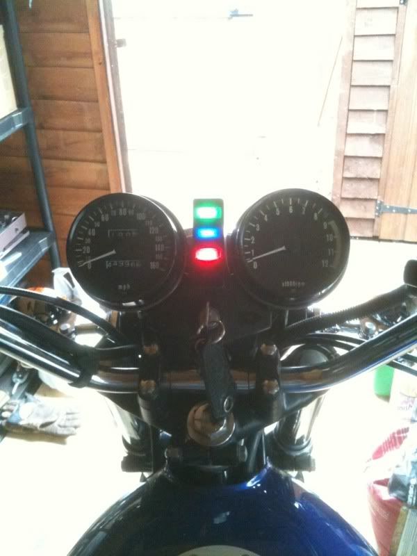

these 2 photos are with normal filament bulbs
these 2 are with colour LED BA9S fitted...the light is not difused as filament bulbs and the brake idiot light is constantly on and just gets brighter when u pull the brake? but the colour is fine
these are wth white LEDs fitted... with white LEDs fitted the colours look a bit wishy washy and the neutral looks more like light blue, in the last photo the brake light is back to a filment

#6 PostAuthor: Mark Tiller » Wed Aug 10, 2011 7:42 pm
to difuse the light a bit i rubbed the plastic glass part with fine wet and dry untill it was opaque and they now look the biz.
