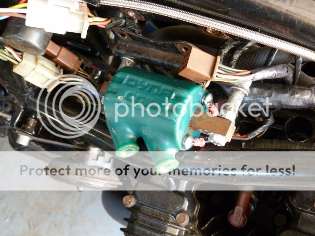

#7 PostAuthor: martinz1000r » Sun Jun 26, 2011 11:11 am
Here is what I mean. First picture standard coils:
and the Dyna coils:
I do not have this issue on my Lawson so wondered what other Unitrak owners have done.

#8 PostAuthor: martinz1000r » Sun Jun 26, 2011 11:13 am
PS I know it is not attached to the frame before any smart alec points it out :D
It make negligible difference.

#10 PostAuthor: Taffus » Sun Jun 26, 2011 1:44 pm
swap the brackets from left to right. the z angle will then tuck the coils further in rather push them out as they are now
