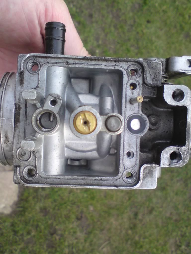

I've decided to pull the carbs (Mikuni) and while i was doing this with the seat off i turned round and noticed the negative terminal connections on teh battery were slack as hell!!,surprised it started!Wonder if this could have caused any problems?Hope not!Carbs are off,no turning back now!
P.S Can anyone tell me where a pilot or idle jet is on these carbs?I thought it would be next to the main jet in my pic,but it's blanked off with a black plug?
http://www.thegsresources.com/gs_carbrebuild.htm
Follow this link its off gs resources site usa Cheers Paul J
