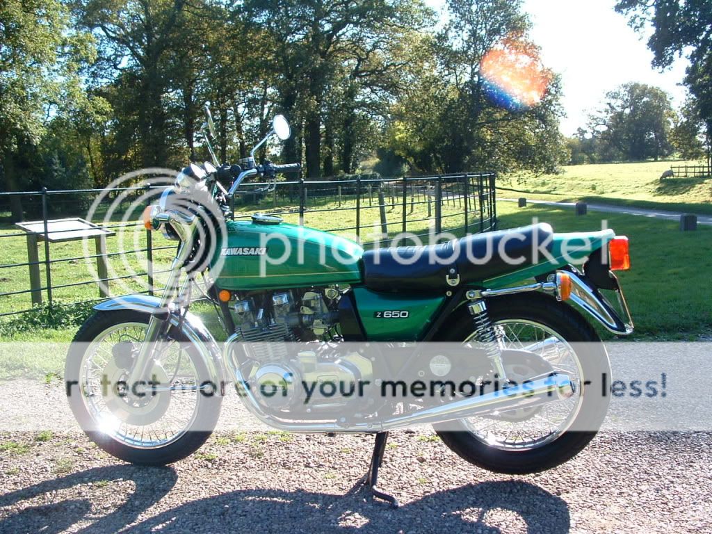

I,m sure someone has the answer...but just wanted to comment on nice picture :D

Same here, dont no anything about petrol tanks but i do know a nice bike when i see one :D

Me to cant answer your question but thats one sweet looking bike

Great looking bike. If the tank has been petsealed or similar the best way is to have it chemically removed, there is a product which makes it turn like jelly. If your tank is as good as it looks and giving no other problems, I would leave well alone. The finish on the inside of mine looks like bare metal.

Lovely looking 650 :drool

Them early Z650s were stunning especialy in green :drool and THAT one is particularly nice :!:
