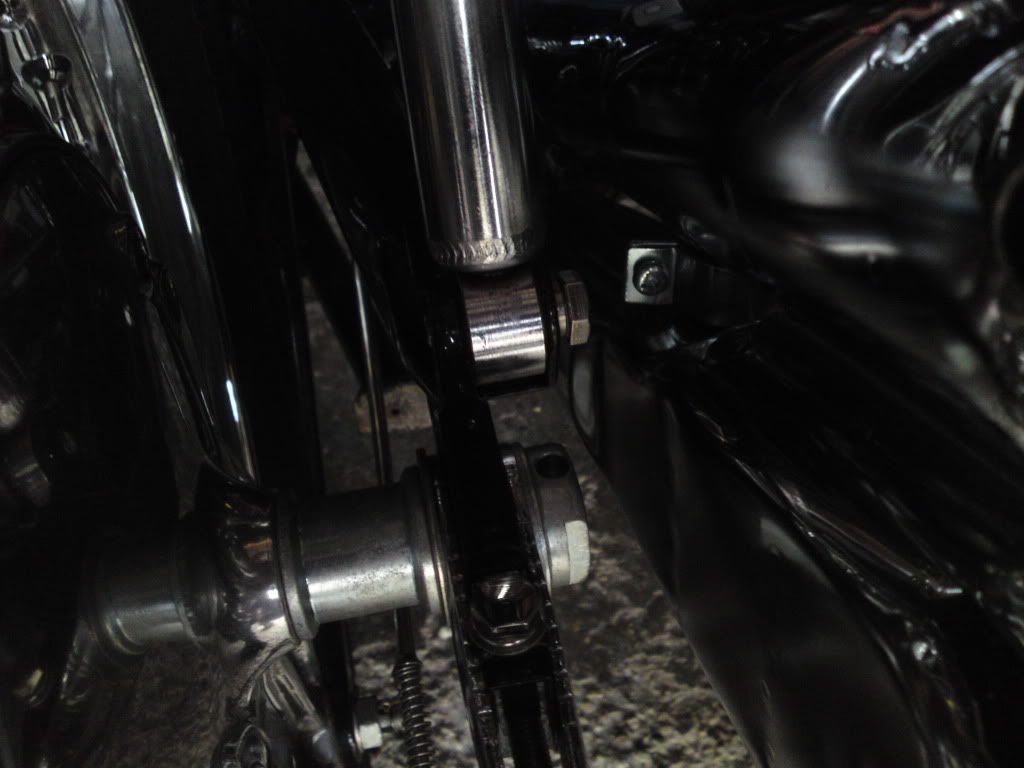

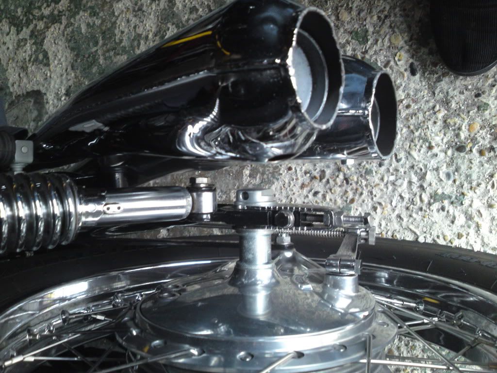

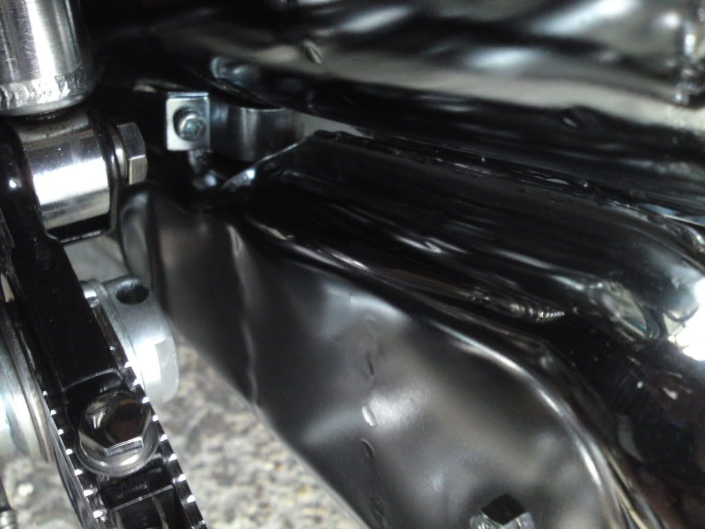

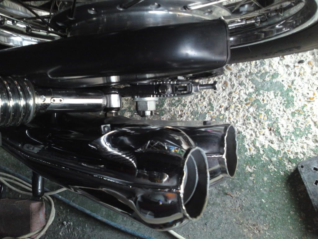

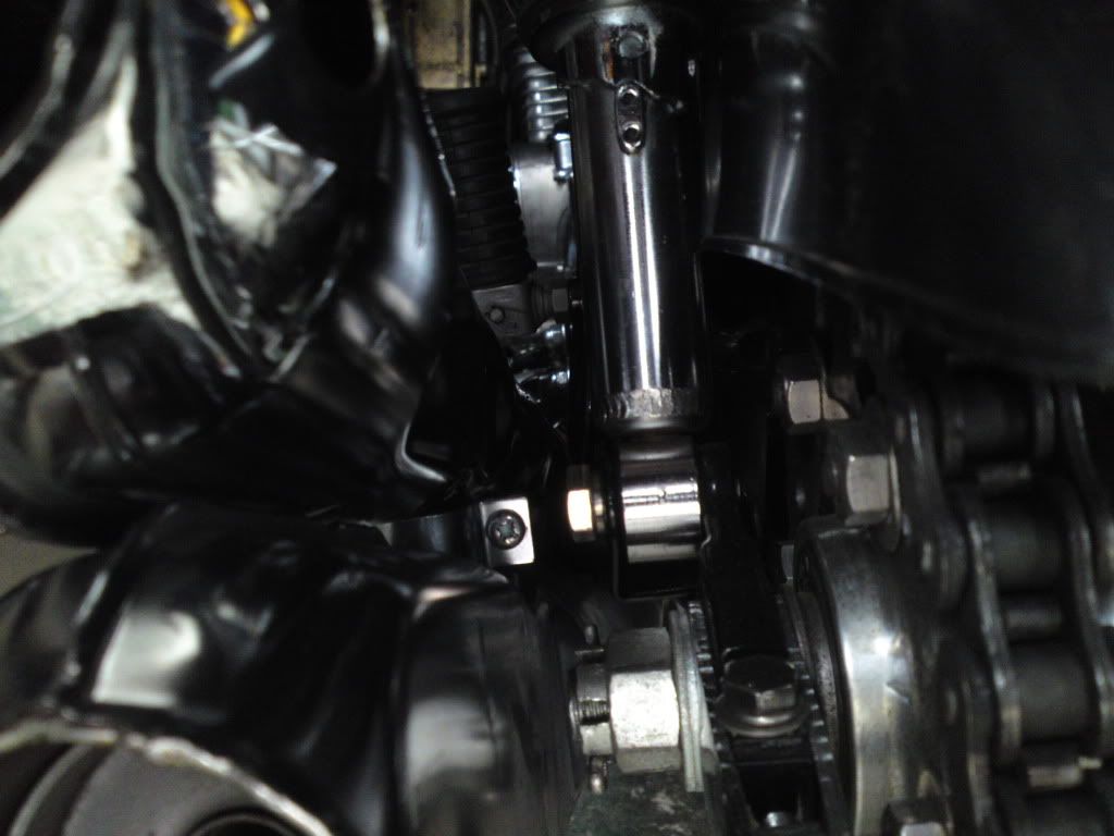

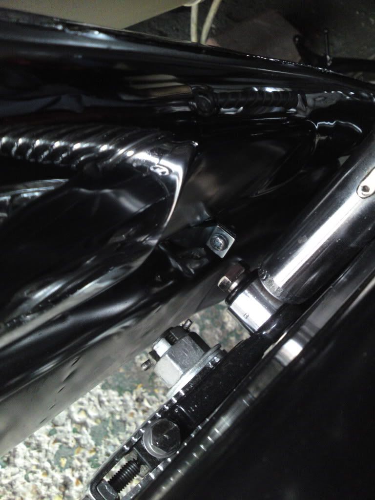

#3 PostAuthor: Steve Cooke » Sun Feb 07, 2010 10:33 am
Any use?

#4 PostAuthor: jimmock » Sun Feb 07, 2010 5:30 pm
Thanks guyz.
Steven your chrome was too shiney to get the shape properly due to all the reflections !!!!!!!! But I still managed to get the idea.
Thanks.
