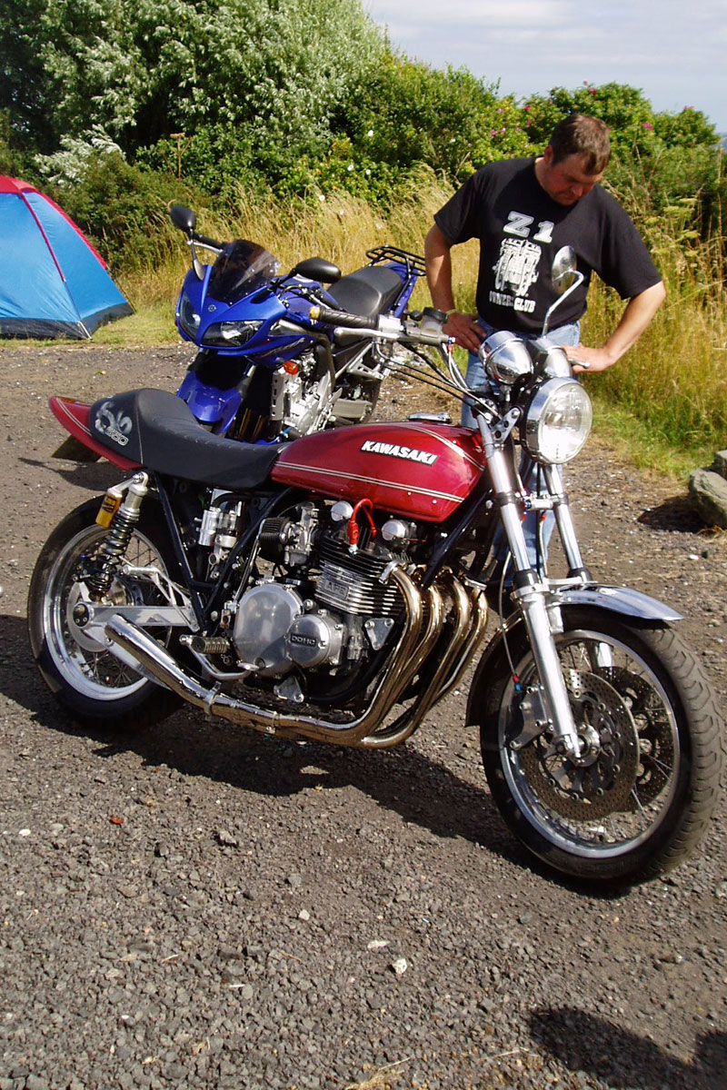

#3 PostAuthor: chrisNI » Thu Jan 07, 2010 12:38 am
PAULJAC47 wrote:You *cannot* fit an early Z900 / Z1000 motor into the z650/z750 frame.
Found this on another site can anyone add to this ?
Unless you're very determined...

#4 PostAuthor: PAULJAC47 » Thu Jan 07, 2010 4:42 pm
Looks Great
