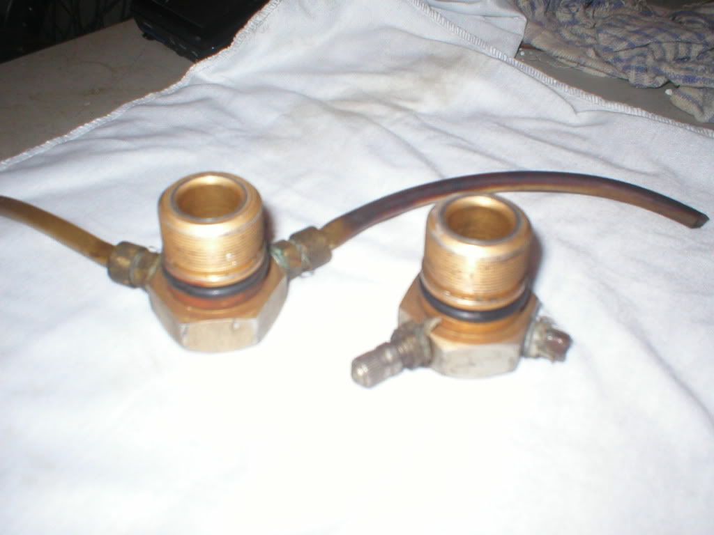

i have two top nuts ,but they have a pipe from one to the other,and a tyre valve on one,to have air over oil.from california.

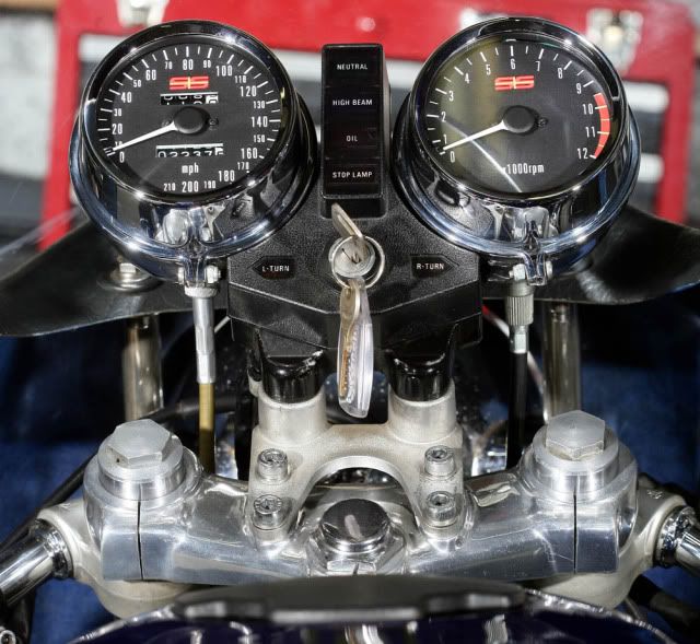

#3 PostAuthor: Big Fluff » Tue Dec 29, 2009 2:57 pm
HB. They can't be off Betor forks then... Betor only ever made naturally sprung forks, never air assisted to my knowledge :?? :roll:
Mine are the simple screw-in type as below. In fact, you can see the 'vent' hole on the LH top nut.

hillbilly wrote:i have two top nuts ,but they have a pipe from one to the other,and a tyre valve on one,to have air over oil.from california.
they are then not for a Rickman

#9 PostAuthor: hillbilly » Wed Dec 30, 2009 12:56 pm
my fault rong forks :oops:
